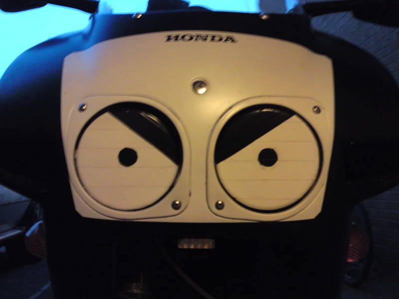

More importantly your Hi/Lo switchgear will melt/fuse if you use the bigger bulbs? A major improvement would be a HID kit, still only pulling 35w but MUCH brighter! I will get round to buying and fitting one when it gets dark in the evenings again, at the moment I have the headlights taped up in a comedy style.
http://i109.photobucket.com/albums/n61/ ... C04069.jpg
