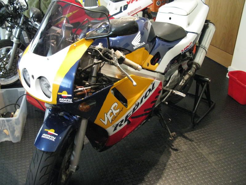

Calling all electrikery boffins - HELP!

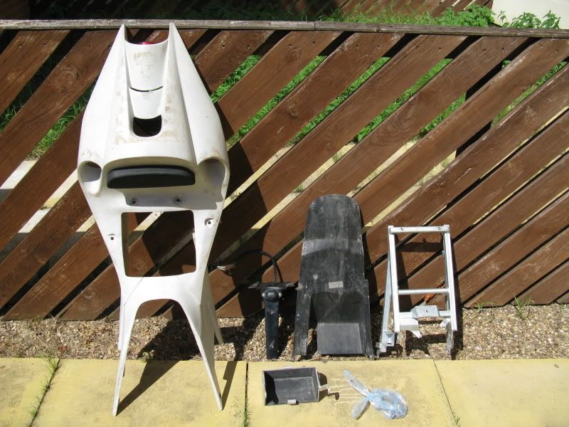

Yesterday i picked up my latest aquestition ie a UK spec NC30 with Tyga tail unit LED rear light etc etc. I never intended to keep the Tyga rear end on the bike as it is not my taste, but in work today and found outi am going overseas again - Arghhhhh!
As such my plans for a UK SPec rebuild have been binned and i am now just looking at shifting the bike on so i only have the two to mothball when i go (anyone want a UK NC30?).
I had already started removing the Tyga seat unit sub frame etc and replacing it with the OEM stuff so i decided to finish that, put some spare fairings onto it (that i had lying around) with the intention of then putting it up for sale and selling the Tyga unit seperately.
Finished swaping things over and whilst the bike starts and runs ok - as soon as you put any load on the engine it goes to (what i assume is) the limp home mode. It was perfect before the swap over so i am thinking it is somthing i have or have not done.
The previous owner had cut some of the wiring and redone the terminations with bullet connectors to accomodate the LED rear light and dinky indicators. I have modified the normal rear light wiring to bullets and sleeves and that seems to work fine.
As he had an LED rear light before - is there something i should be looking for (resistor/diode etc) that i now need to remove from the sysytem as we are back onto normal tail/brake lights?
I havn't yet done the indicators - would this have an effect?
Also as this is a UK bike there are two extra wires at the back end for the number plate light. I was not going to bother with this and was just going to tape the wires out of the way. Would not being conected through a light cause a limp home mode?
Whilst re routing the wires aftere the sub frame went back on i disconected the HT leads on the back cylinders for ease of access. Not sure if i got them the right way around when they went back - but can' t decide if this would make any difference. Do both cylinders fire at the same time (ie both rears) or is it x1 rear and x1 front that fire in pairs - i never can remember.
I am sure i am just 1 wire away from it being back on song - so any help greatfully recived :pray:
