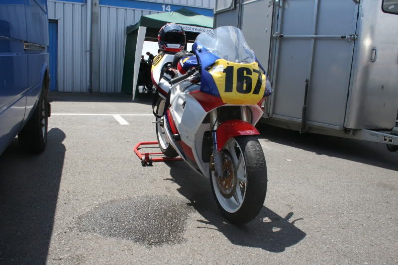

Here is a pic of the bike working (and not)
