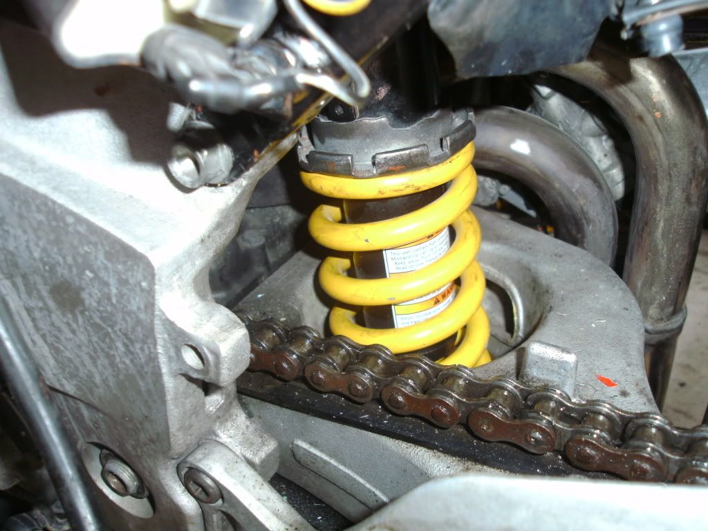

you can fit an sv 650 shock to a nc30. this cost me two pints of stella down the pub so was worth a try just so i can get through the mot.

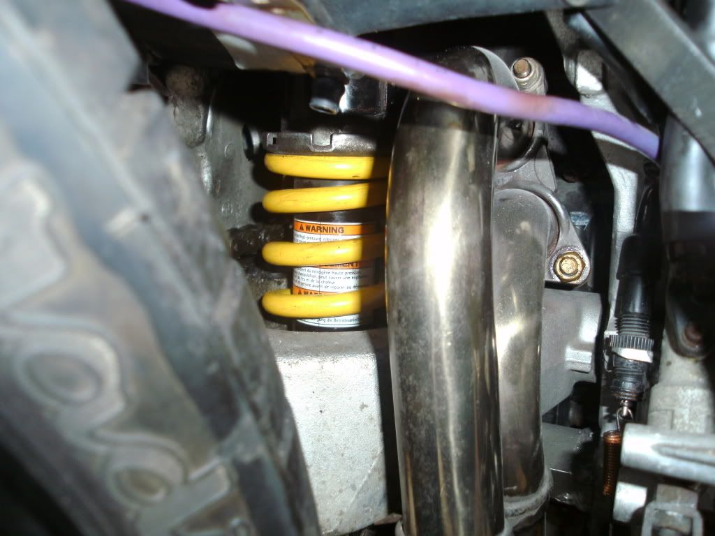

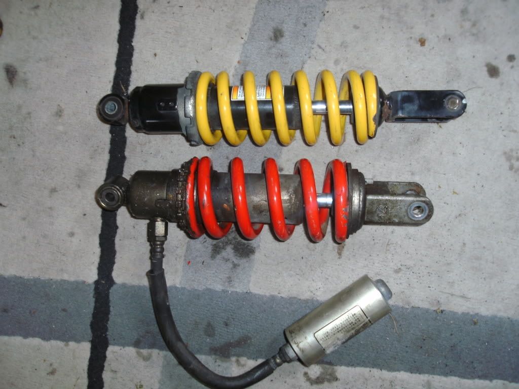

2001 sv shock against my well used original

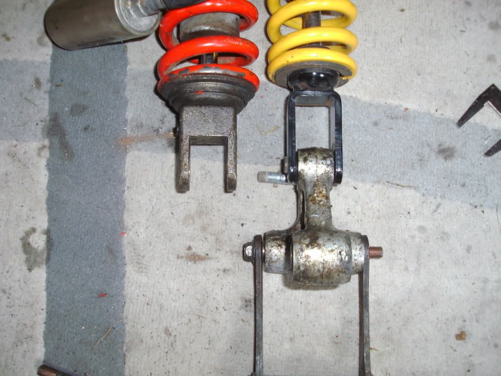

offering up the dog bone & linakages - pretty much a simple swap
took a bit more work than it looked to get it to due to the length difference, new holes on the shock had to be drilled to reduce the length centre to centre but...
i have gained about 12mm in ride height, the rear end is far firmer and it will even make fitting the cbr tail & undertray easier as i no longer have the resevoir to worry about!

Out of interest, what was the length difference between the shocks without the new holes in the SV shock?

off the top of my head it was around 30mm, i tried the standard holes first but found the rest of the dog bone linkage would not line up with the mountings on the bike ( to short ), so i had to drill news hole for this to work.
it was a fiddly job, though there is no real adjustment ( comapred to a maxton etc ) from this shock, it is a lot firmer than the original, which i am happy with, it has raised the height just ever so - which is better for me.
