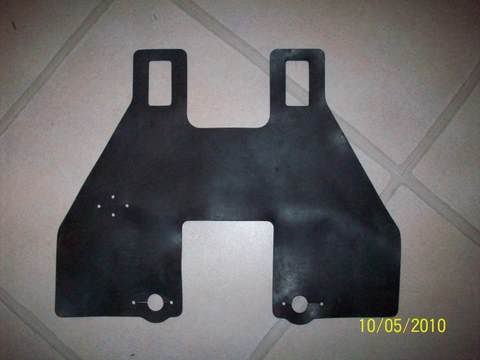

Does anyone have a picture of how the rubber flap fits that is associated with the airbox? I'm normally quite good at working this sort of thing out but this has beaten me!
Do the carbs need to come off to fit it?
Heres a picture of the flap I now have, anyone know if its the right one for an NC35?
What is its purpose in life?
Thanks in advance.... :oops:
