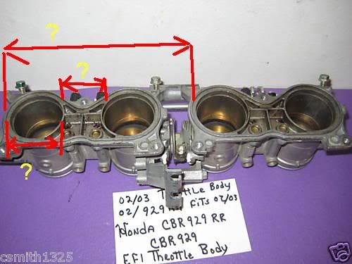

I get following response about this throttle bodies from cbr929.
in side to motor is 11.5
air box side 12 inches
port hole about 12 inches
If anybody have carb and motor in garage - could you check ? Because I haven't spare motor for now..
