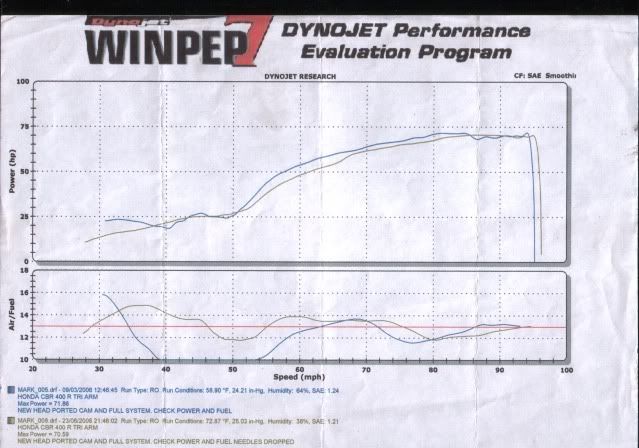

CBR400 NC23 Dyno sheet
Just tidying throught the house loking for my travel insurance and came across this old dyno sheet from when i raced my cbr, this bike was previously dynoed when standard plus an end can @ 62, all parts were sourced from GF and then i modded the carb slides to let e get the needles a little lower to cure the fueling. The bike went well and totally smooth with no flat spots or hesitations onced dynoed, spec was standard bottom end with new rings, modded head, race cams, full stainless system. all in cost me around £900 for all the parts so pretty good. Wish i could get me nc30 tuned for that sort of money.
