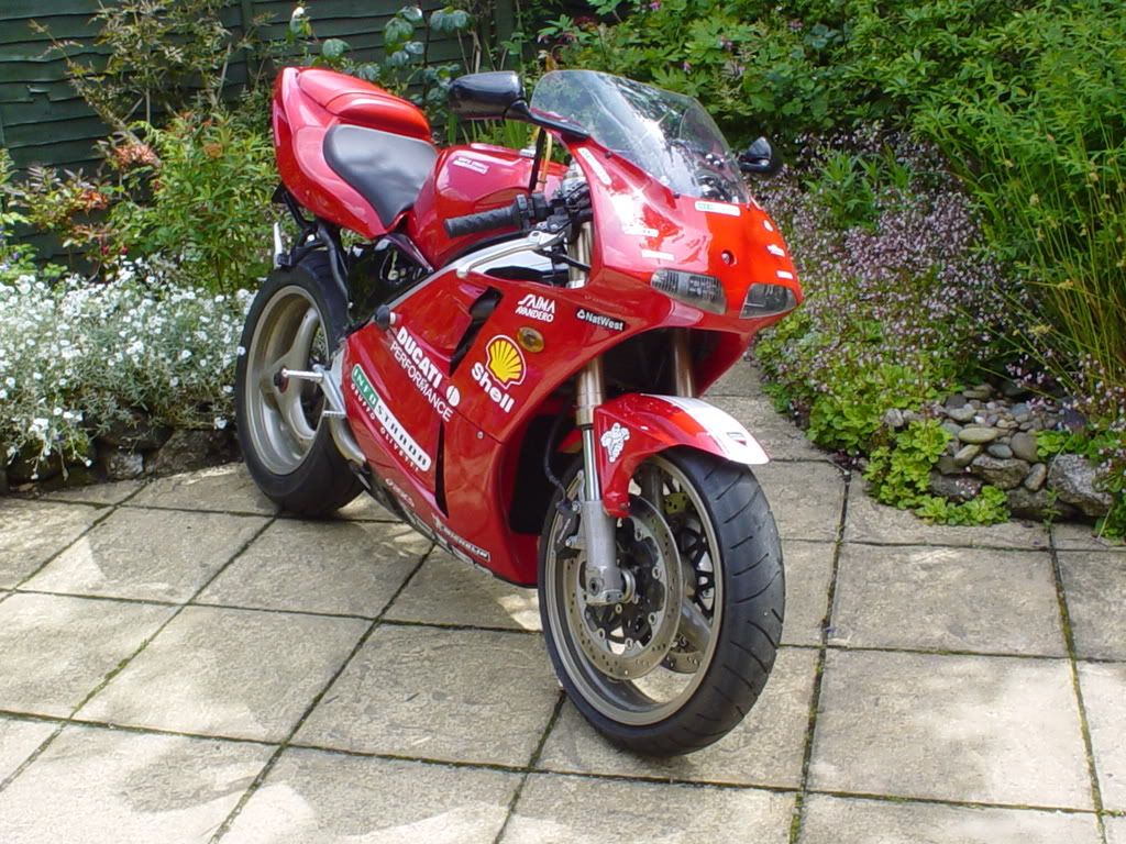

You could go down the Ducati rear wheel route as I did a long time ago with my NC30
But it was difficult to source the modified wheel and then it was offset to oneside.
