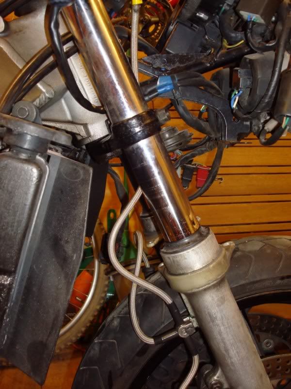

I got some braided lines the other day but i'm just not entirely sure that they're 100%
They seem to be sitting funny ..
If anyone has got any ideas that would be smashing :)

sack them and get two individual lines to the calipers - looks better if nothing else..that looks messy and not quite right :o

well... i was trawling ebay.. as you do. and was wondering..
Perhaps, the small section of braided line should go to the master cylinder, thus allowing the longer lines to to off to their calipers?

Thats an old style of set up that is!
The short line is supposed to go to the master cylinder, and the splitter is meant to mount on the bottom triple clamp, while the two longer lines go to the calipers.
Personally i'd go for the two line kit.
