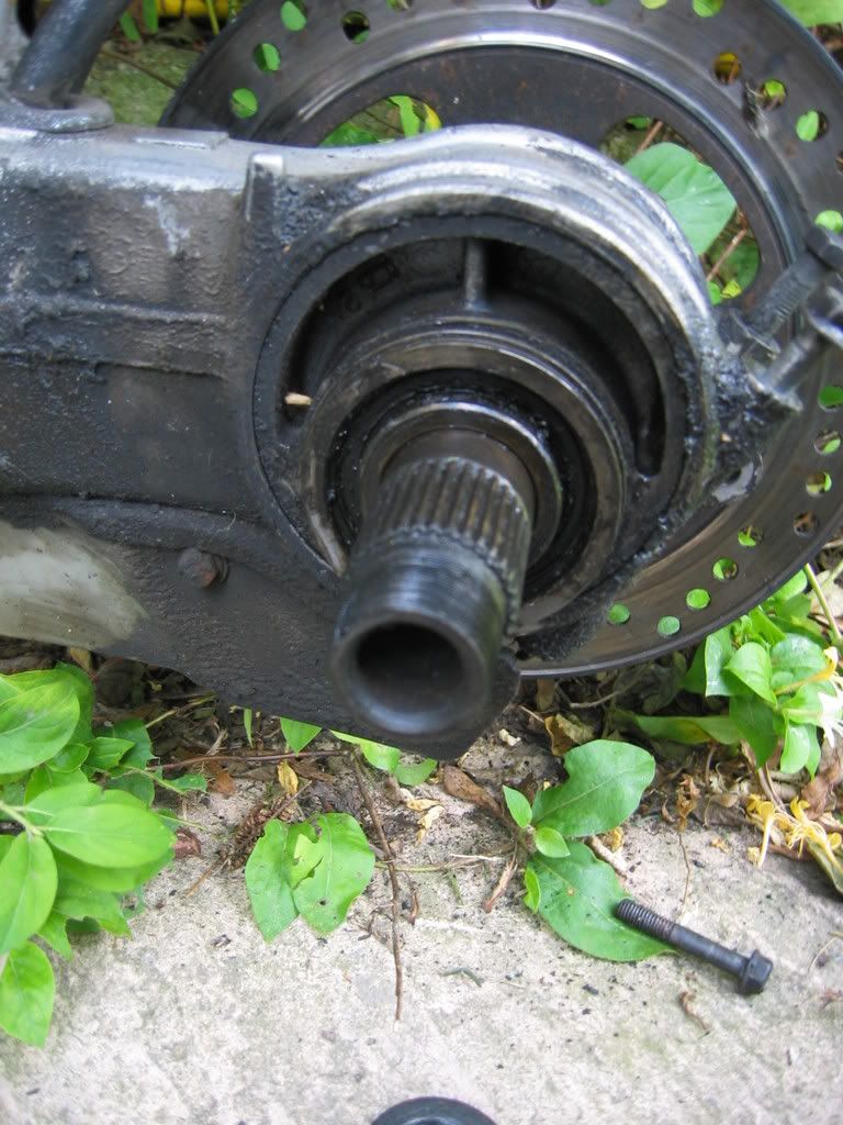

alrighty so in this picture
http://www.jacksons-lair.co.uk/nc24xx/axle.JPG" onclick="window.open(this.href);return false;
collar #7 seems stuck
show here
http://i46.photobucket.com/albums/f115/ ... G_1103.jpg" onclick="window.open(this.href);return false;
(thanks to Neosophist for both photos)
which is preveting me to gettign to the snap ring(or circle clip) and thus removing the the axle.
i dont see any major damage, however i cant pry it off with screw drivers....
im tempted to cut it out, as i am planning to make a new shaft anyways...
anyone have advice? thank you!
-Levi

Do not cut that out, that part is no longer manufactured and it is not made anymore either.
It is not attatched to anything so will just pry off. Mine came off simply by lifting it out.. Sprary it with lots of WD40 and leave it for a bit, lever it off with some small screwdrivers but be careful not to score the axle itself.

Hmmmm. good to know!
im thinking it might have deformed some, as there is abit of a raised lip on one side of the spacer... so i might not be able to just pry it off.... but i hit it with some oil and am letting it sit over night.
because im planing on doing away with the cush drive, or heck, swapping to a NC30 spindle, the spacer is not the most important piece.... and if need be i can always make one or have it made
Thanks again forthe info. ill give it another shoot tommrow morning and give an update then *crosses fingers* im mostly worried cause its spins very freely, and has about 10 thousands of inch slop up and down, almost feels like its stuck on a grove.... i did try the prying with screw drivers, and got nothing.... but hopefully the oil will help....
Thanks!
-Levi
Thanks!
-Levi

i got it!!!
the reason it was stuck is due to the previous onwers abuse.... the coller had been presed on hard enough over time to cold form it under the snap ring sum....
i had to pry pretty damn hard with the screw drivers to get ti started on one side, and then work my way around, breaking the material off.
its off, and now i jsut need to get the snap ring off, not seeing any problems there, just need some time :)
Thanks a bunch for the help!!!
-Levi
-Levi
