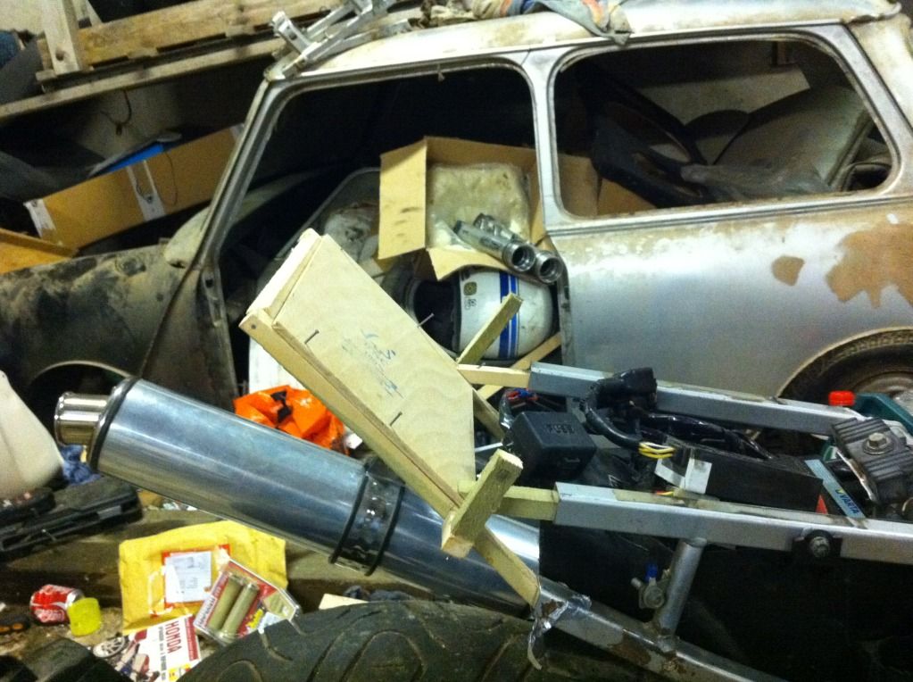

Also been making a race subframe, because,
A, im trying to do this on the cheap
B, I enjoy fabricating stuff, even if im not that brilliant at it, never wull be if idont keep trying will i!!
C, Gives me something to do.
Anyway mocked it up outta timber, which was pretty easy thanks to me dad being a joiner and having a joinery shop, right tools for the job makes things a hell of a lot easier, chopped up another rear subframe i have and now going to replicate it in metal. hoping once ive got it done and im happy with it ican give it to my dads mate whose a fabricator by trade and he can copy it outta alloy.
Other than that im getting close to being all done,i think/hope.

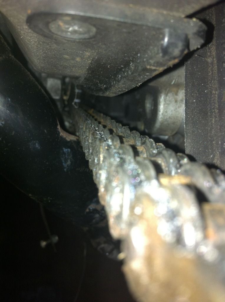

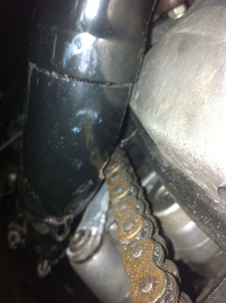

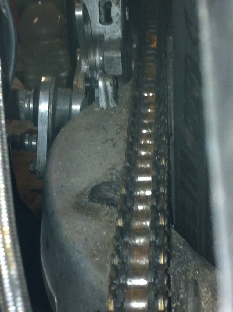

bit concerned about the chain and micron pipe tho, things look real close and im thinking the chain will rub on the exhaust where they cross just behind the lefthand (gear change) side rearset??!?!
could have sworn id taken some pics but cant seem to find them and back at work down in wales so wont get chance to get any till next weekend, how much chain whip does an NC30 experiance?

This is with the bike on the rear stand, so effectively with the weight of the bike on the suspension, and no matter how much i fiddle and adjust i cant get much more clearance.
Granted when i sit on the bike i get more clearance but im a bit worried about chain whip, as i'd imagine that the chain will go through the pipe in seconds!

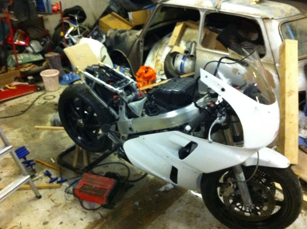

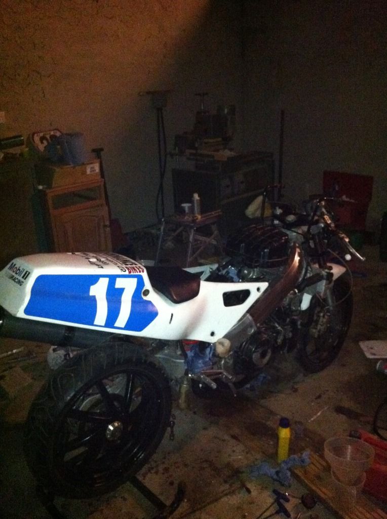

this is how the bike stands at the minute, not my number though, these are the fairings and numbers the bike came with.
Need to sort the front screen brace and clock bracket to take the NC35 fairing then im thinking i might have a cheeky run down the back lane. ridden it the length of the workshop, so my maiden voyage was all of 10m!! exciting stuff!

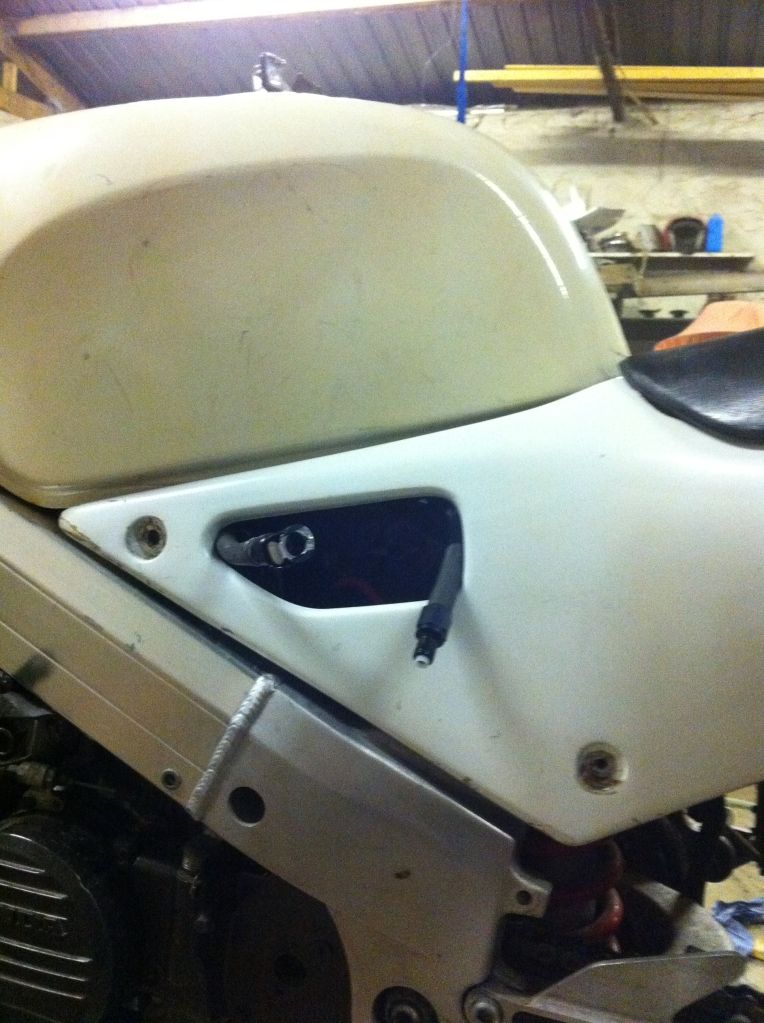

Started by trying to sort out the fuel line dry break, which i wont repeat as its in another post on here. but it went well and im happy with the result and the routing.
With this done it means i dont need to remove the tank everytime i need to undo the dry break. Been thinking about this yesterday and think i will wrap the now longer fuel line in some exhaust packing as a heat shield, as while the fuel line doesn't go anywhere different to where the original fuel line went it may sit and rest on the rocker cover so thinking belt and braces is the best policy.

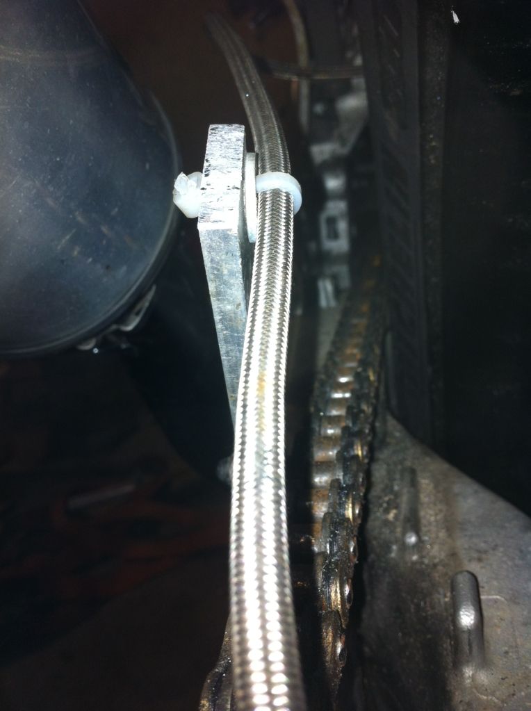

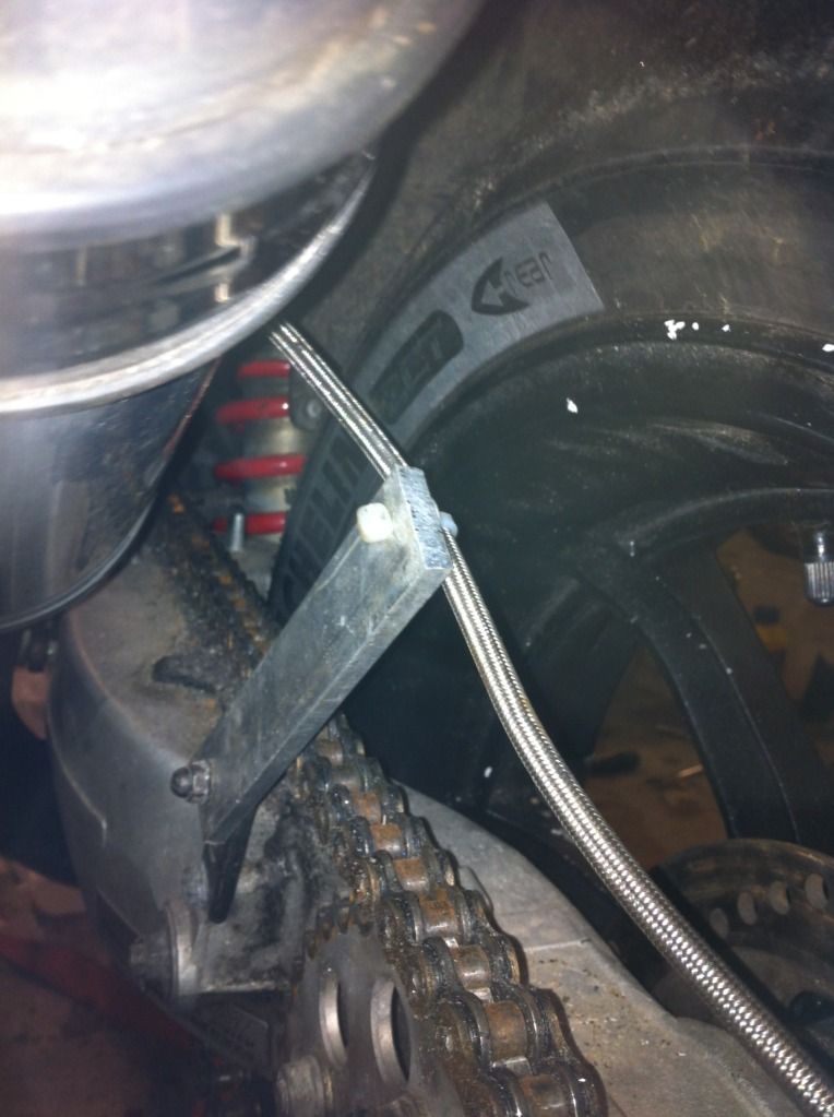

Also had a look and making some brakeline brackets for the rear brake. I do a fair bit of mountain biking and used a fix for the cable that we use to fix brake cables to the down tubes of the bikes.
Basically you just use a washer with a zip tie threaded through it then round the the cable and back out the washer again. This stops the cable being able to pull through the zip tyre and also spaces it away from the bracket and stops it chaffing against it.
Looking at it my bracket is ever so slightly on the chunky side so think i will cut it in half length ways and use this half for the front bracket. Quick Q tho, will this pass tech inspection?
Also got my tyres fitted, another quick Q again is this spacing between tyre and chain ok?

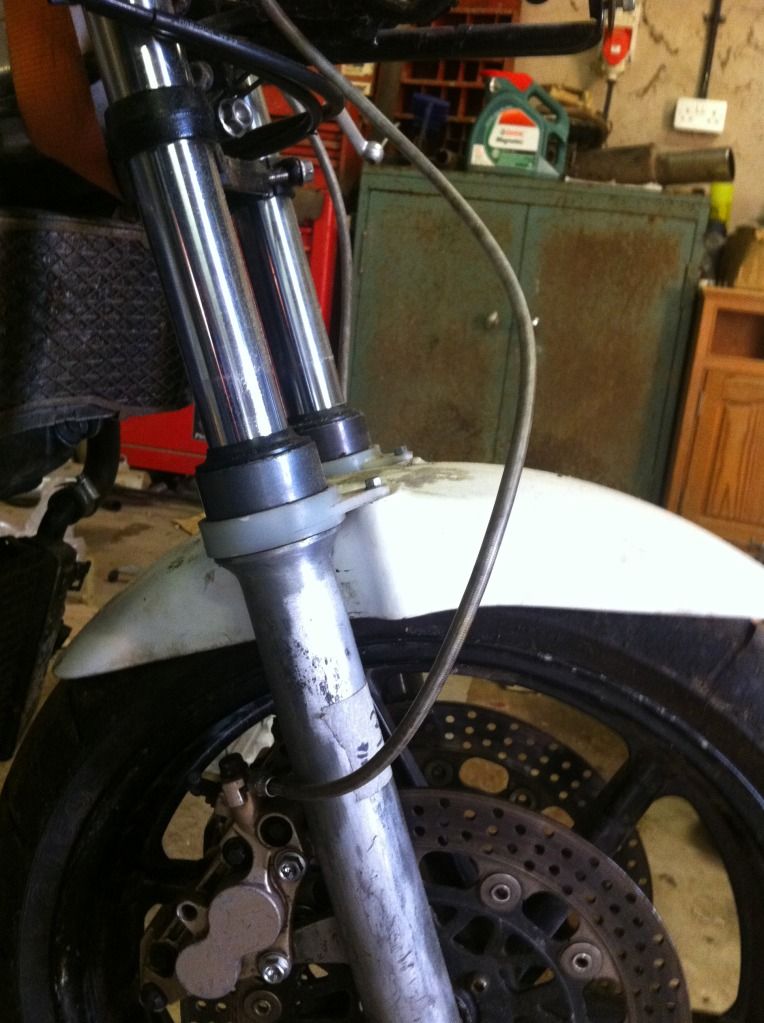

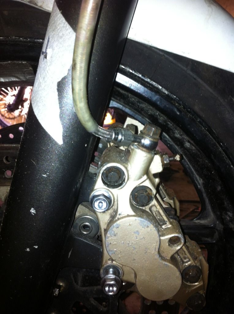

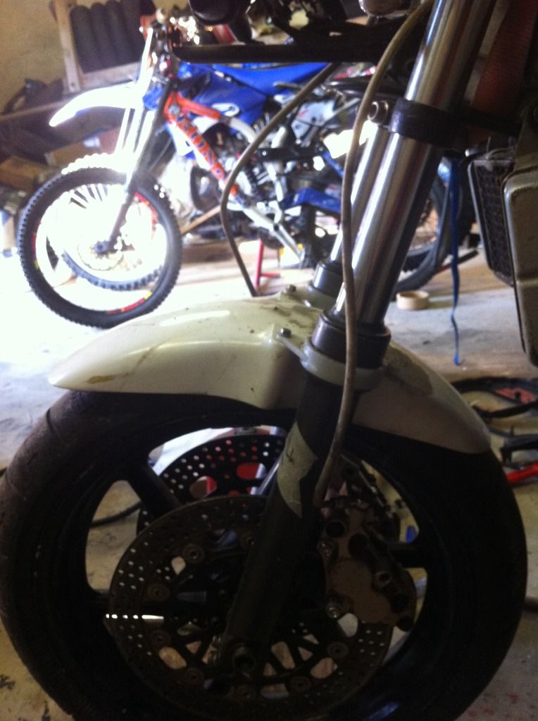

Haha one more quick Q, front brake lines, ive noticed some braided lines have a 90degree banjo fitting, mine dont?? is this ok, ie again will it pass tech inspection?
