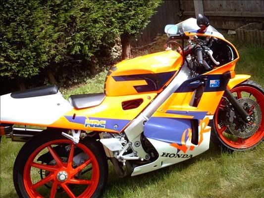

thought i would show you guys what i have replaced the problem machine with
might not be to everyones taste yes it dayglo orange :oops:

Post by Matchlessman » Sat May 09, 2009 10:06 pm
Mike,
Thats erm, well..... Orange.
How does it run?? Hopefully its better than the last one!

Post by VFR..Al » Sat May 09, 2009 10:26 pm
That does'nt look too bad mate...lets hope you have more luck with this one ;)

Post by Sligeach » Sun May 10, 2009 12:19 am
that yoke was for sale at boxhill last summer. hard to forget a bike like that!! did you buy it in the locale?

Post by mikevo » Sun May 10, 2009 10:10 am
went to spalding to collect ,guy bought a ducati in 2007 and this has just sat in his garage since then he has owned it for 11 years and i am only the 2 uk owner :grin:
runs really well bog standard at moment
may well get a new tank , tail unit ,and fairing in black and red (last style) if the dayglo gets on my nerves
knew it wouldnt be to everyones taste or even anyones taste :oops:

Post by Matchlessman » Sun May 10, 2009 11:15 am
Sorry! I didnt mean to be so negative. Its a bit in your face but the colour scheme is probably the easiest thing to change if it gets on your nerves.
Having a bike that works is the main thing and its good that you didnt get put off buying an NC30 after the last one.
Happy Riding!! :up:

Post by mikevo » Sun May 10, 2009 11:45 am
paint work is very 90s lol
just glad to be back on the road
never know the guy i bought the first bike off may break it ;) get bodywork off him
if i keep it this season this colour need get black wheels the red makes bike look even more stupid :lol:
