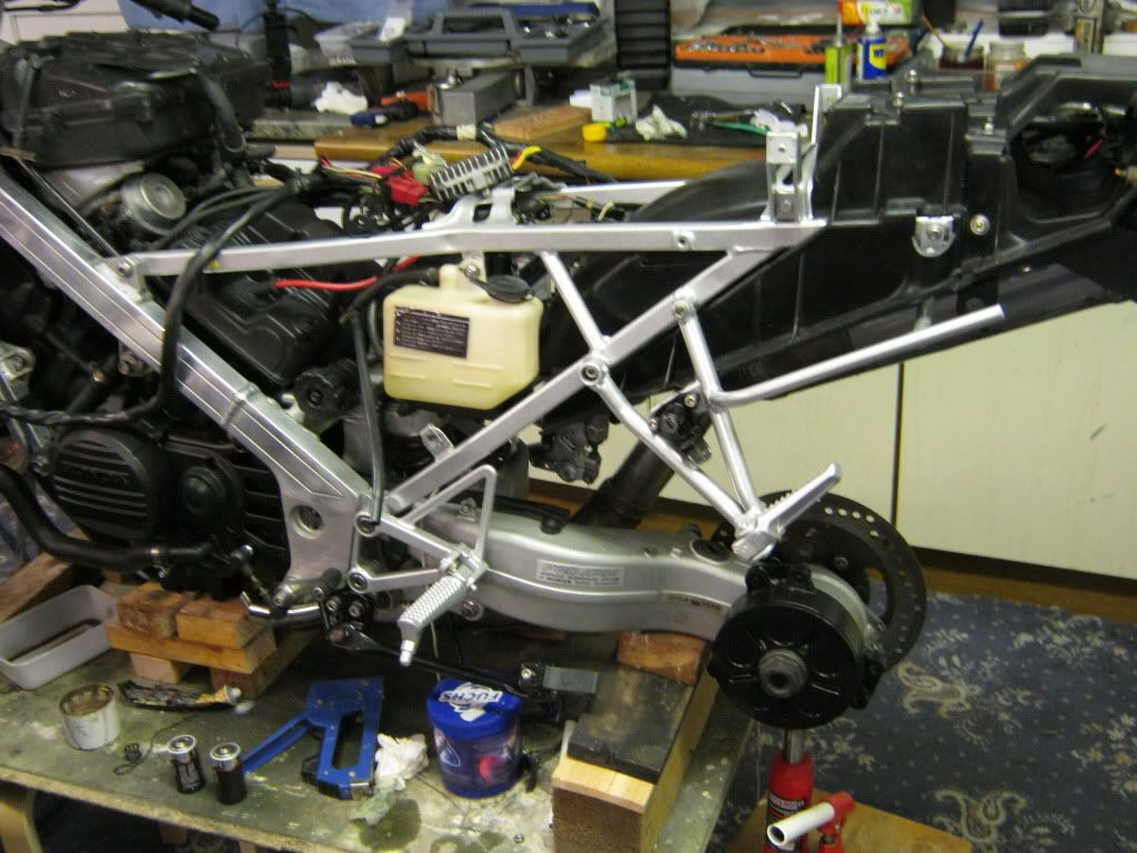

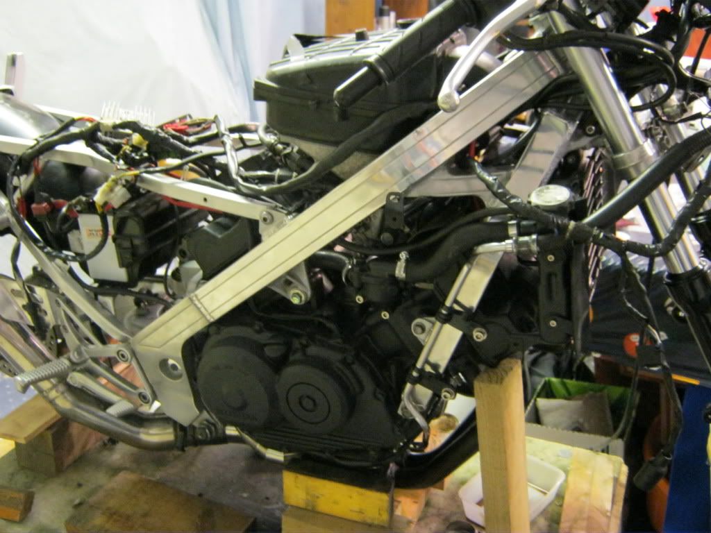

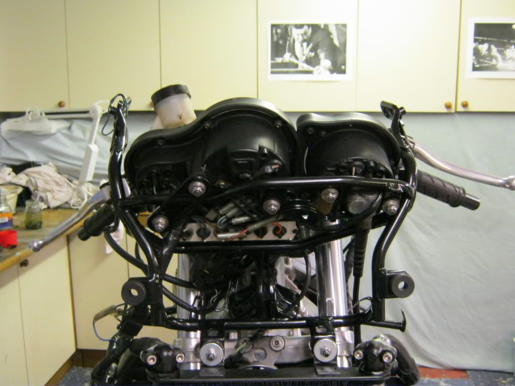

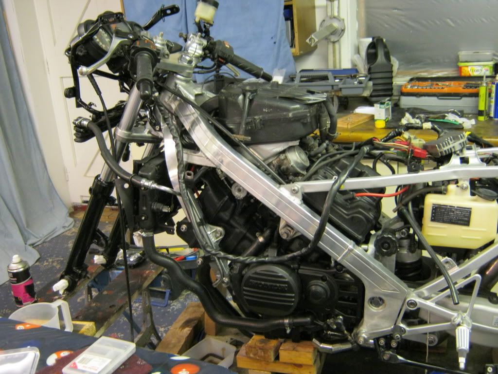

I've finally managed to get some pictures taken so you can see what we've been up to.

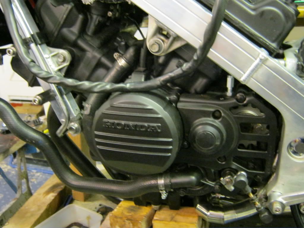

The collector box has been fitted along with all the pipes.
As you can see it's looking pretty good so far!

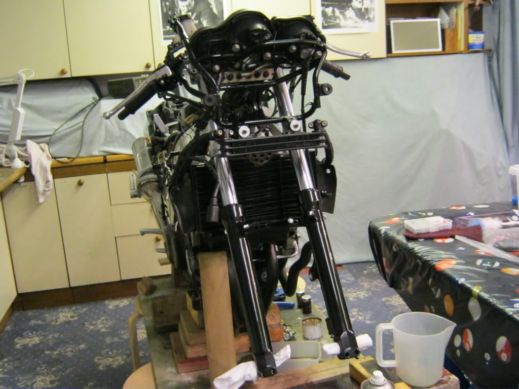

The front forks kept leaking at the damper bolt so we had to get a tool made up to hold the damper rod in place while we torqued up the bottom bolt. They were then fitted and hand tightened for now.

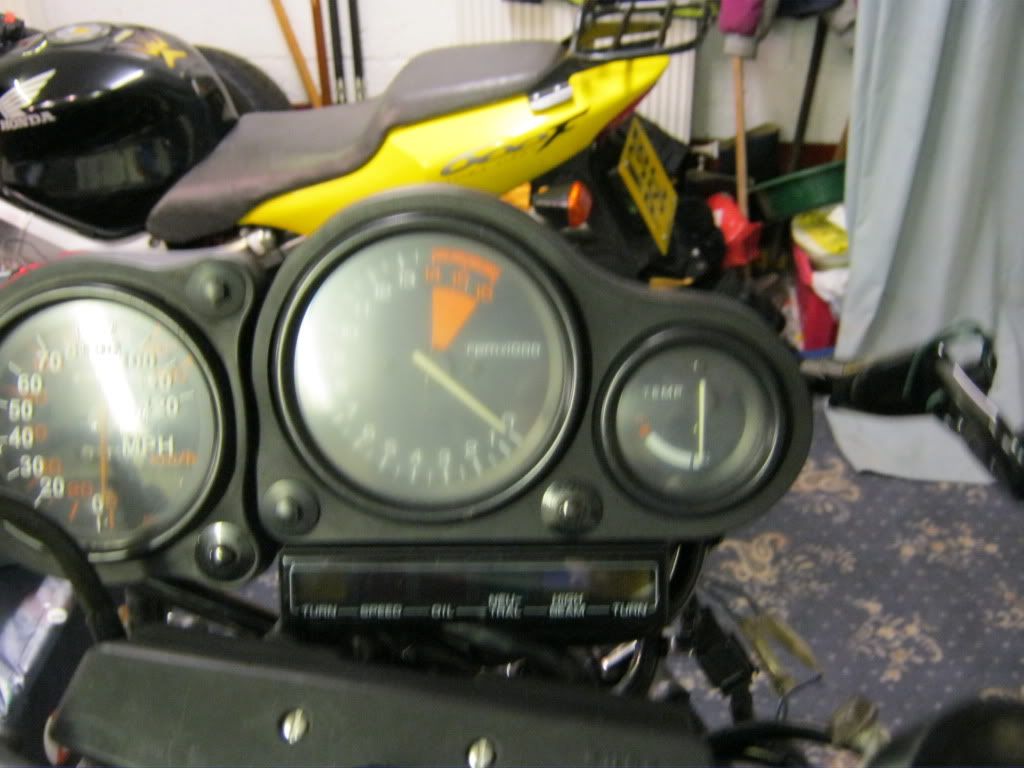

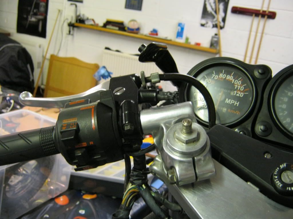

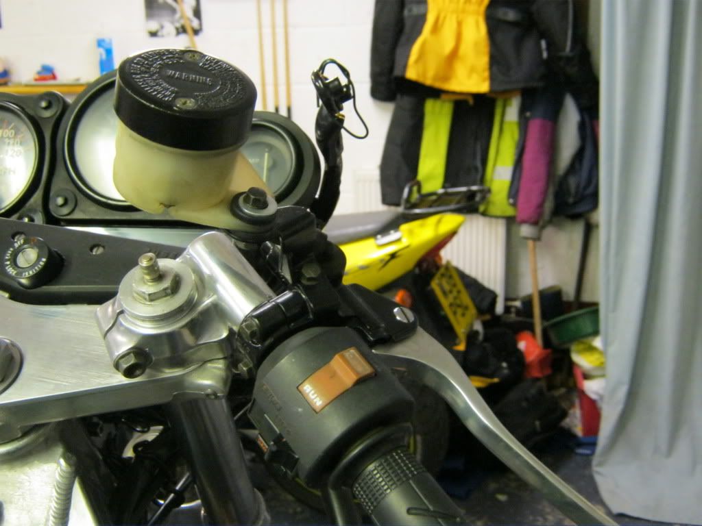

Here are a couple of pics the now mounted restored controls.

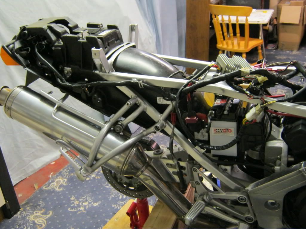

We managed to get the engine started last weekend too. It seems to be running ok, but we'll get the carbs balanced at a later date. The whole bike is sitting precariously on a bench so we didn't want to rev the engine too much in case it started moving under the vibration. the throttle does work though, so things are looking good.
- Posts: 35
- Joined: Mon Jul 05, 2010 8:23 pm
Re: NC 24....about to start project (EDIT...started)
The electrics seem to be working too. The horn indicators etc. there was a bit of a problem at first but my dad eventually traced it back to the light bulb socket inside the rear light section.
