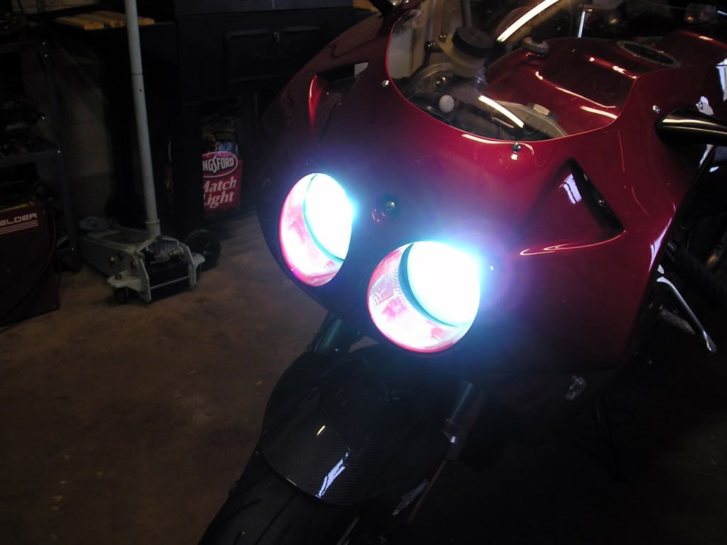

They are the 6000k. I got the Xetronic Digital kit from here...http://www.xtralights.com/xetronicdigit ... ingle.aspx
Now they have the G2 version, which is even smaller. I also got the bi-xenon option and got two of course.

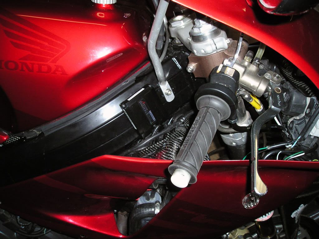

For the NC35, I would go with something like this..
http://www.theretrofitsource.com/produc ... cts_id=221
They are small enough to fit in there and attach to the H4 socket, so a little modding may be in order.

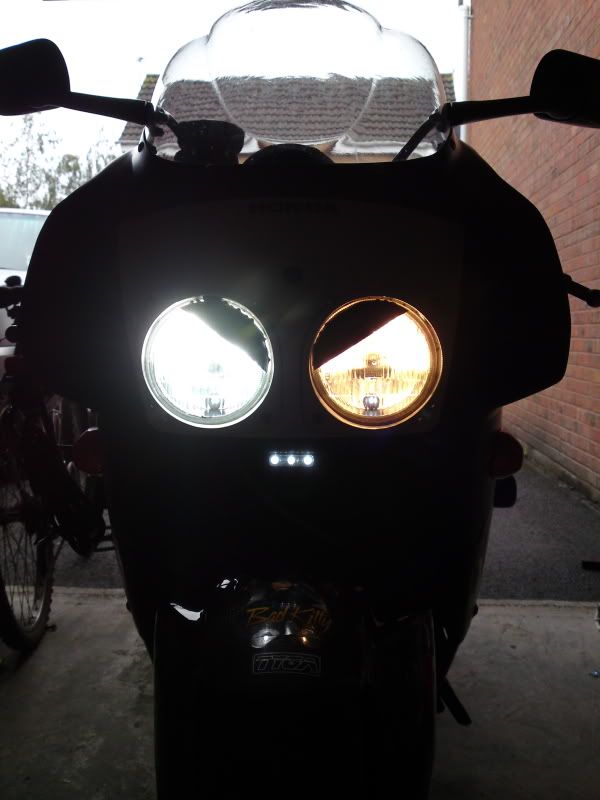

Just bought one of these for my NC23, will let you know how it fits/works etc...
http://cgi.ebay.co.uk/ws/eBayISAPI.dll? ... 4093wt_911
- and yes - I know its only one side... if its as good as I hope it will be I'll only be running one headlight in an endurance - stylee

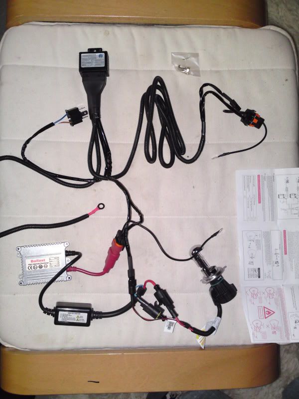

Yay!
http://i109.photobucket.com/albums/n61/ ... C04231.jpg
Anything over the pathetic yellow glow of the 35/60w standard bulbs can only be an improvement...
http://i109.photobucket.com/albums/n61/ ... C04230.jpg
Kit is straightforward - Run a wire from the battery + to the red lead, connect the earth lead to the righthand or lefthand top rediator mount, fold the tabs back on the bulb adaptor and fit along with a H4 adaptor plate (USA ebay),
fit the rubber cover then twist the bulb into place.
Mount the ballast under the headlights on the nosecone, snap all the connecter's together, and bingo - Bright Light.
