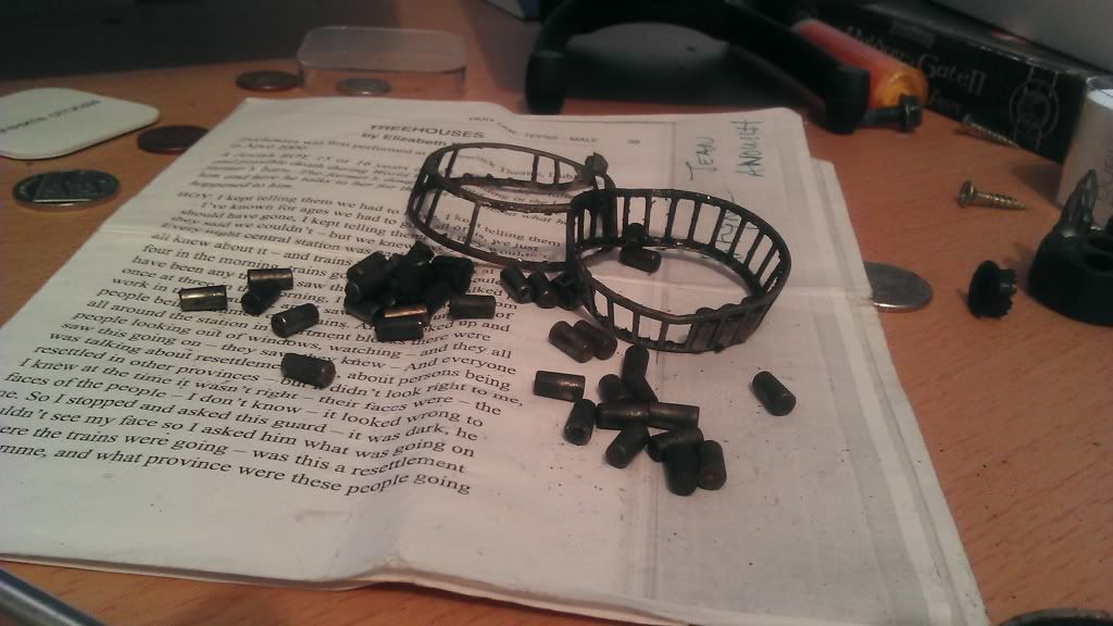

Re: sticky yoke or steering?
Sounds like a bad idea to me.
Do you have any pictures of the lower bearing you removed?
I've always replaced them in pairs... tapered needle rollers are cheap enough to buy a set.

u wanna see pics of the bearing? :D okay. here are the pics of the bearings.... as i removed them they crumbled into pieces. the bottom bearing looked fine, until i took it out and the whole thing crumbled.
here is the stem with the lower bearing attached... looked fine, turns fine, but sometimes jams...
and here it is after i removed them, along with the top bearing crumbled too....
now, all i need, is ONE lower bearing inner race. i do not need the whole set, because ive already placed an order on them bearing kits on eBay... so i am only looking for one of those inner races that go on the lower part of the stem... anyone got a spare please?

The crack is that they are a set of two parts - the races and the bearings. Swapping one and leaving the other is no the best idea and as a result the odds of finding a spare lower race unused is pretty slim.

Bad idea.
As Mark has pointed out.
They wear as a unit. Even though it might look fine it will have wear on it to match the old bearing (there aftermarket bearings btw as they didn't come with needle rollers as standard.)
If you try to fit an old lower bearing with a new outershell the wear will be different and it's likely the bearing won't roll properly.
http://www.wemoto.com/bikes/honda/vfr_4 ... balls_usa/
It's 28.50 for a full set from Wemoto. you can't grumble at that.
http://www.ebay.co.uk/itm/ALL-BALLS-STE ... 35b9f9adba
Same as this (same price too)

so what do you suggest then? if i cant find a spare lower bearing inner race, what am i suppose to do? ive got the outer racer, and the baearings ordered.... and i really cant use the bearings without the inner race... sooo what now?
