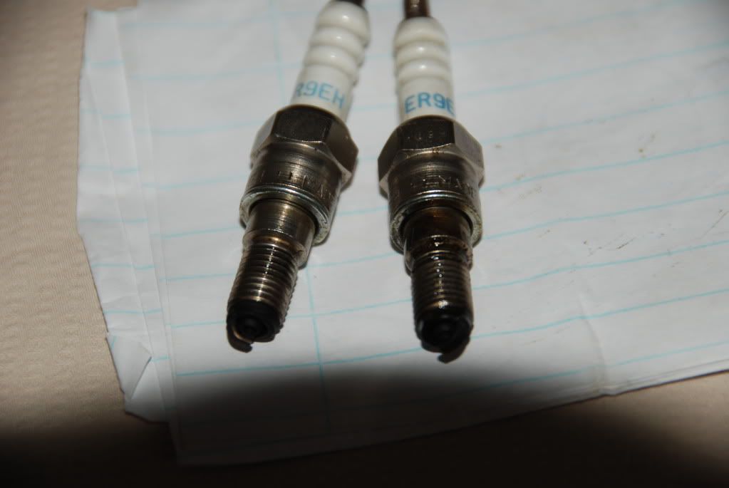

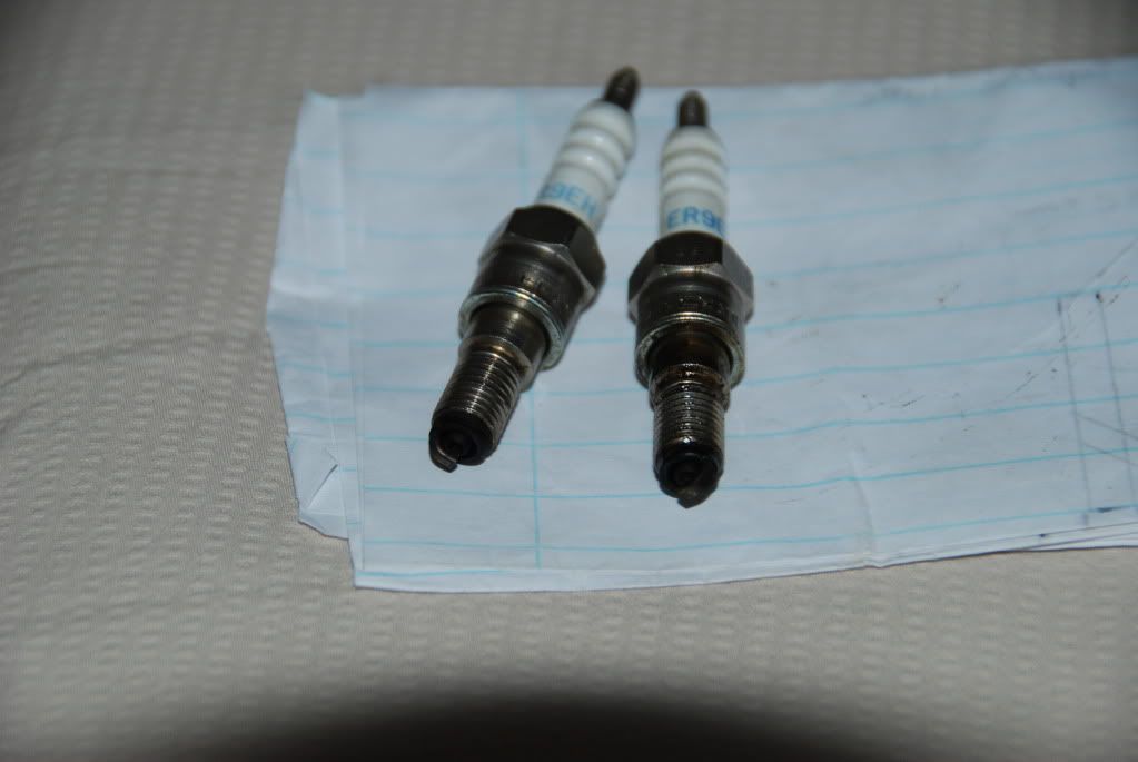

RegionX
Posts: 136
Joined: Tue Oct 18, 2011 10:02 pm
Bike owned: VFR400 NC30
Location: Cape Town
Re: RegionX's Problem Thread
Post by RegionX » Mon Feb 20, 2012 10:45 am
Okay got the plugs out and they dont really look wet at the tips but just below the thread they are a bit wet. Checked the spark and it was as I suspected... Sometimes its sparks as I press the button then nothing and sparks again as I let go, I have no comparison but the spark seems weak too. Now I know what you are going to say, new plugs, but the plugs are only a couple of months old and I had the same problem before I worked on the bike, it struggled to start and when it did take it was as I let go of the button. So, do I clean and dry the plugs? If so what do you clean them with (petrol I would assume)?
If it is not the plugs then what are the possibilities? I dont have enough electrical understanding to work out how letting go of the button would send spark seeing as the button obviously makes good contact and sends signal to the starter motor the entire time.

RegionX wrote:Now I know what you are going to say, new plugs, but the plugs are only a couple of months old
Hard to tell from pics but they look far from ideal to me.
Posts: 7152
Post by CMSMJ1 » Tue Feb 21, 2012 8:12 am
they look pretty coked up - have you tried to burn that shit off them on gas cooker? They get fecking hot...so hold them with something other than your hands!
