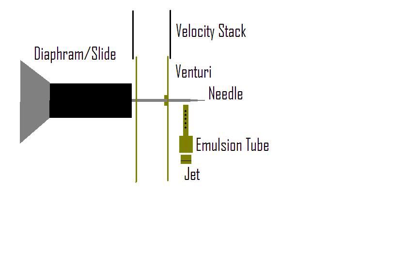

Also - can you explain the reply to Cammo with the T piece drawing? What does that mean? I don't get it (as I am thick perhaps!)
This ;)
i remove the emulsion tube attached a longer hose to one of the slides vaccum hoses (the ones that connect to the subfilter, and blew to watch, the needles draw out which are as i says oposite T to the emulsion and not sitting in the the emulsion tubes as we all expected?)
