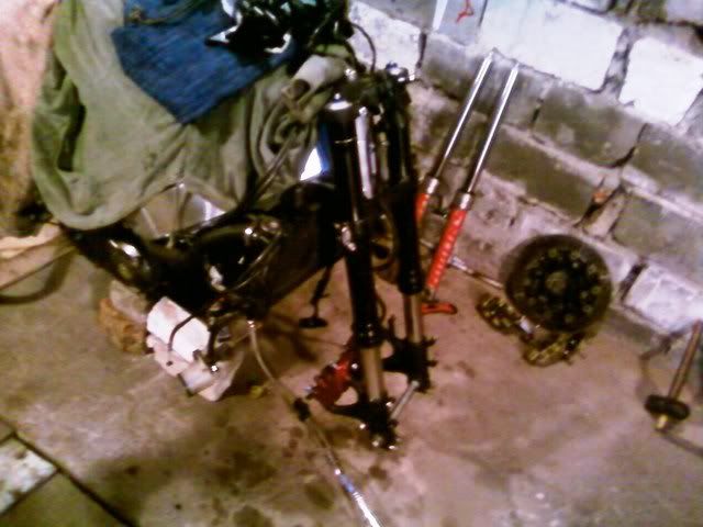

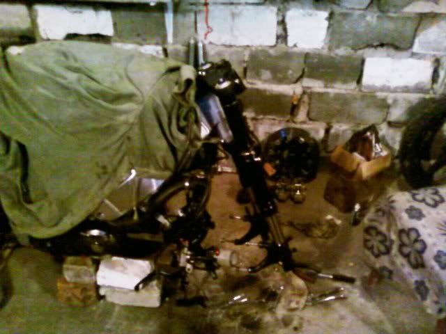

PARUS wrote:Made some photo today.
1. Top and bottom yoke fit straight. Stem length is same, bearings is the same (and interchangeable). All what need to be done is increase holders never bottom yoke. Like picture below.
I use bolt to make holder adjustable.
2. That's all.. all other fit as old forks.
I'm using also CBR600 wheel ( with brake rotors), but looks NC29 also fit with different spacers. And keep in mind that disk on CBR400 has smaller diameter 296mm against 310mm on CBR600.
