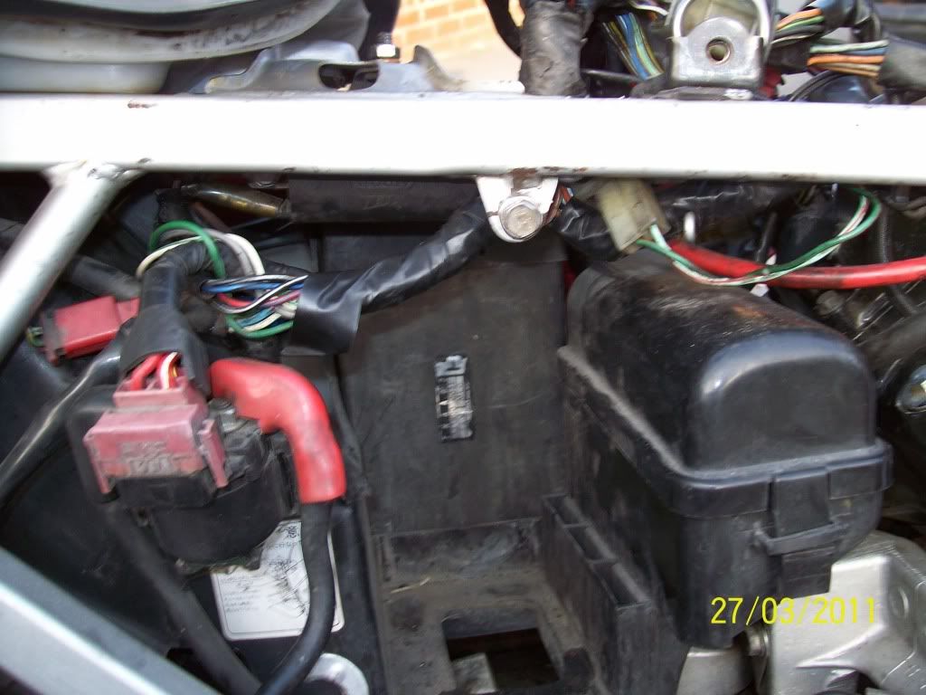

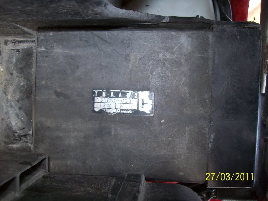

I have taken some pics and im certain i have the nc21 ecu fitted to my bike.
it is identical to one which is on ebay at the moment
how can i post pics?
my nc24 tacho has always displayed about twice what it should but i bought an nc21 tacho to try but the plugs dont fit.
where would you guys start looking with a spark initially but then nothing after a few seconds?? its all a bit strange!

Re: my first serious breakdown, engine died at speed!
this looks like an nc21 ecu to me, what do you guys think?
it ran once, so should run again...
*god i hope so!*
*god i hope so!*
Yes that is the NC21 ECU.
Have you taken off the passanger seat?
There is also an OKI box under there too.
Your bike sounds like it was made of bits.. is that box connected up? What do you have under the passanger seat.
What does your frame number say? (dont give me all of it, just the first 4 digits.. NCXX)
And yes.. it did run so it should run again.
Perhaps flat battery.. did you charge it fully before testing?
thanks neo
i will look for the frame number and engine number tongiht when i get in.
Where can i find these??
I think i can remember you telling my it was an nc24 frame once before.
it has the nc24 exhaust anyway.
yes, the box is definatley connected up. i dont think ii have anything under my passenger seat but will try to have alook.
(i made a luggage rack to make my comute to uni easier, so it might take me longer to get to the rear seat...)
Yeah, i think i agree! bloody bitsa bike... grrrr...
*frustration*
no, i admit i didnt charge the battery to full, (ive lent my charger to somebody but cant remember who.. doh!) i took it out and put it on the fiesta again and charged it from that.
And, i admit, i did try it with the jump leads again, would turn quick and strong, but with no spark..
if i left it for a while (30 mins) it would spark a few times too, but then stop...
*frustration*
The internetmittent spark is an interesting one.
Once battery and electrical connections are ruled out it could well be a failing ECU unit.
Have a look under the passanger seat anyhow and see whats under there. If you take off the right side rear panel (which you had off to look at the battery) you should see two electrical block connectors near the passanger seat at the plastic tray.. they run to the oki box.
hi guys.
well, i had a chance to look at the bike this weekend.
i bought a replacement ECU from Fleabay to use as a swap out to help fault finding.
Gues what... changed the ECU and it runs like a treat again!!!
I know the ECU was a long shot but with how it was running and loosing the spark after a few seconds was probably the weirdest fault ive ever come accros on an engine!!
Glad its running well again!
Thanks for all the advice. Im going to open the old ECU up and see whats causing the fault! i will post up my findings!
