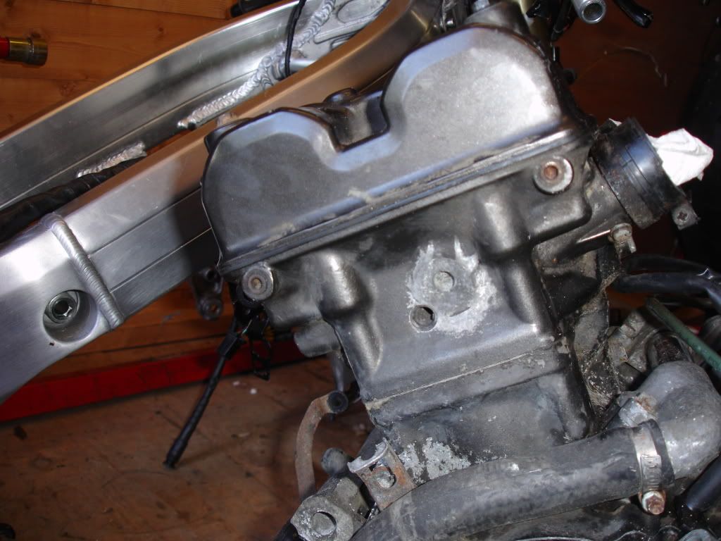

before

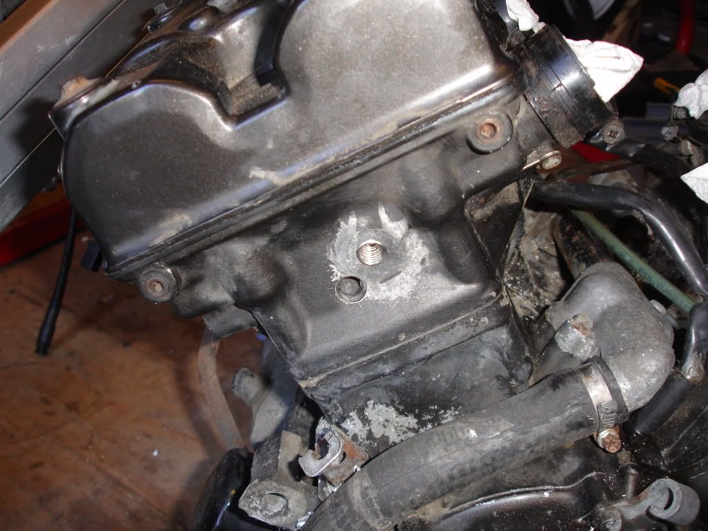

drilled

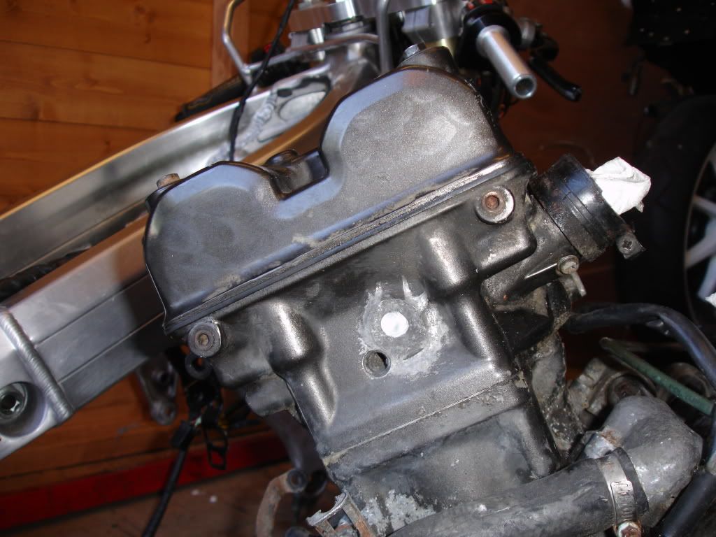

tapped

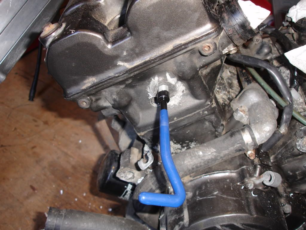

helicoils
I drilled the thread out on the original mounts and just used them as spacers, i'll get some pics of how it looks with the R&G kit bolted on as it kinda connects all the mounts together which should help strengh wise.
