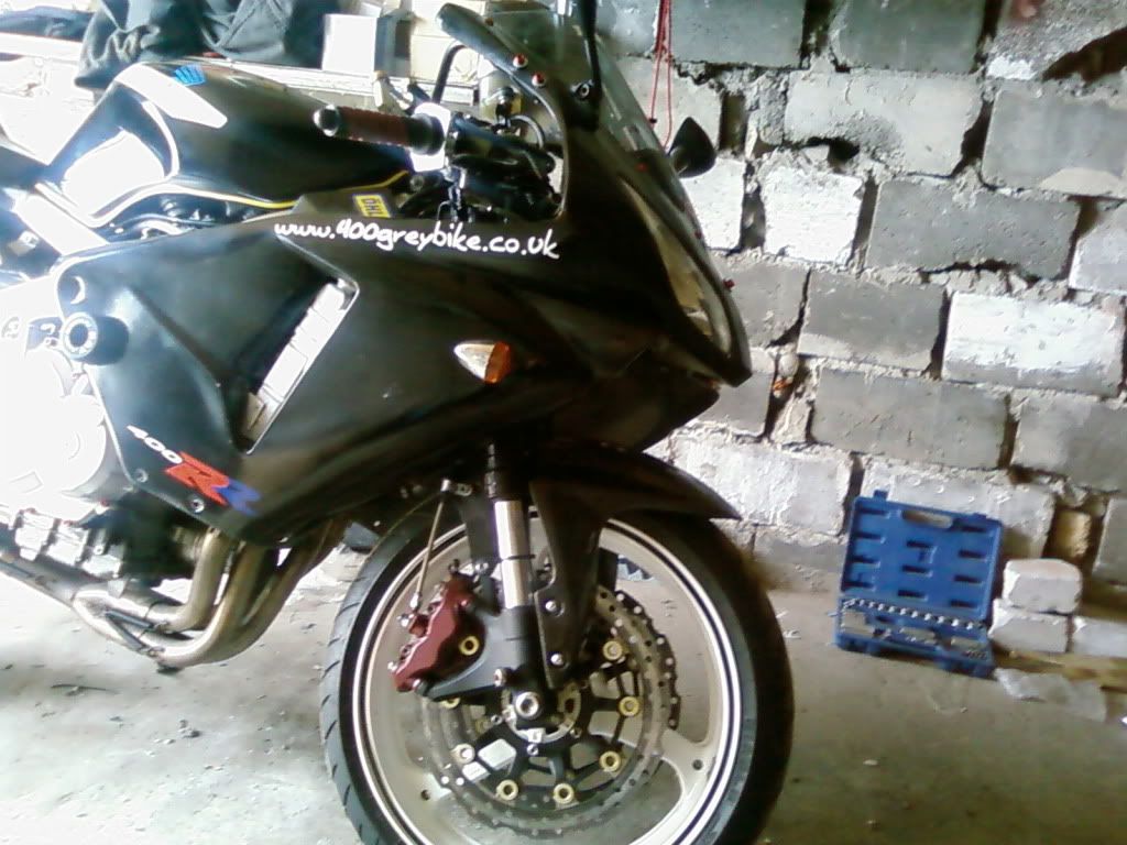

Fitted mine up yesterday. Just need to make some fork stops so it doesn't hit the R6 radiator. Pretty straight forward and easy.

Did you fit full front end or forks only ?

Whole front end, forks, triples, rim rotors and brakes. :grin:
