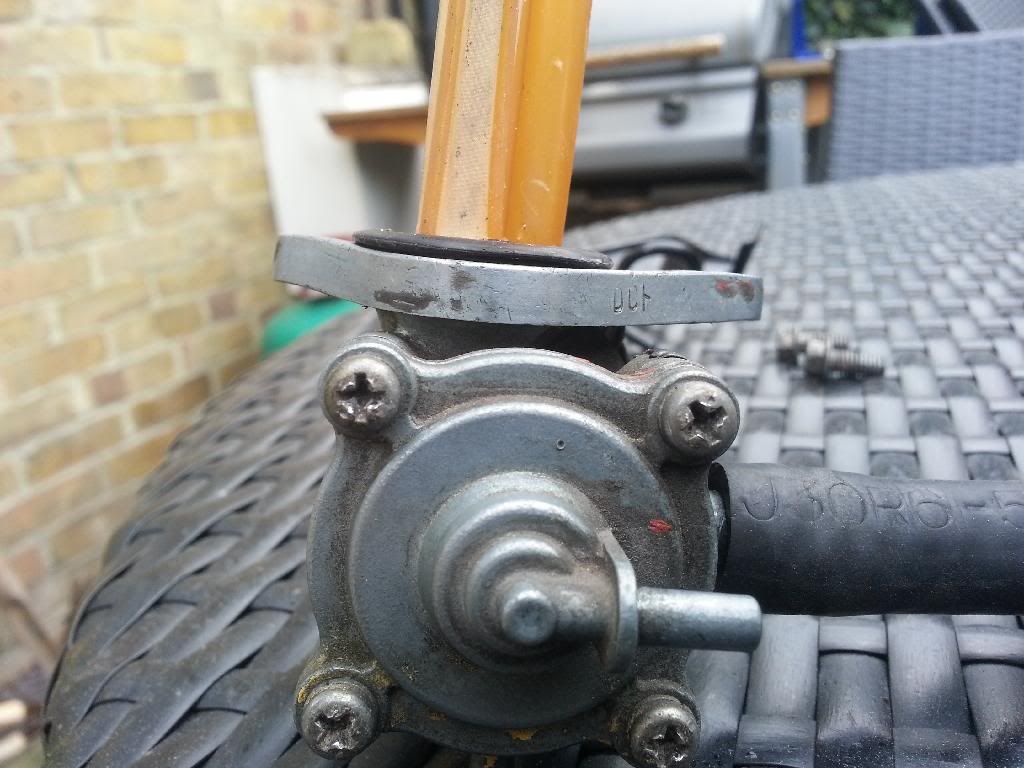

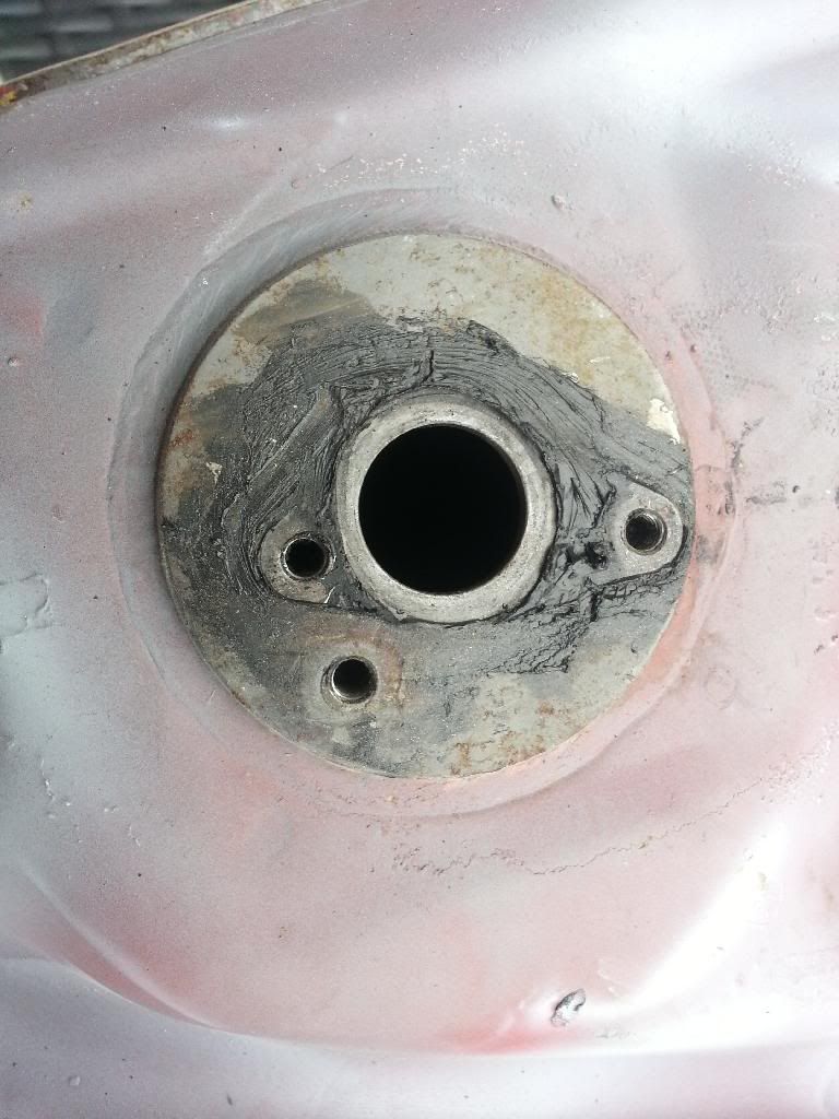

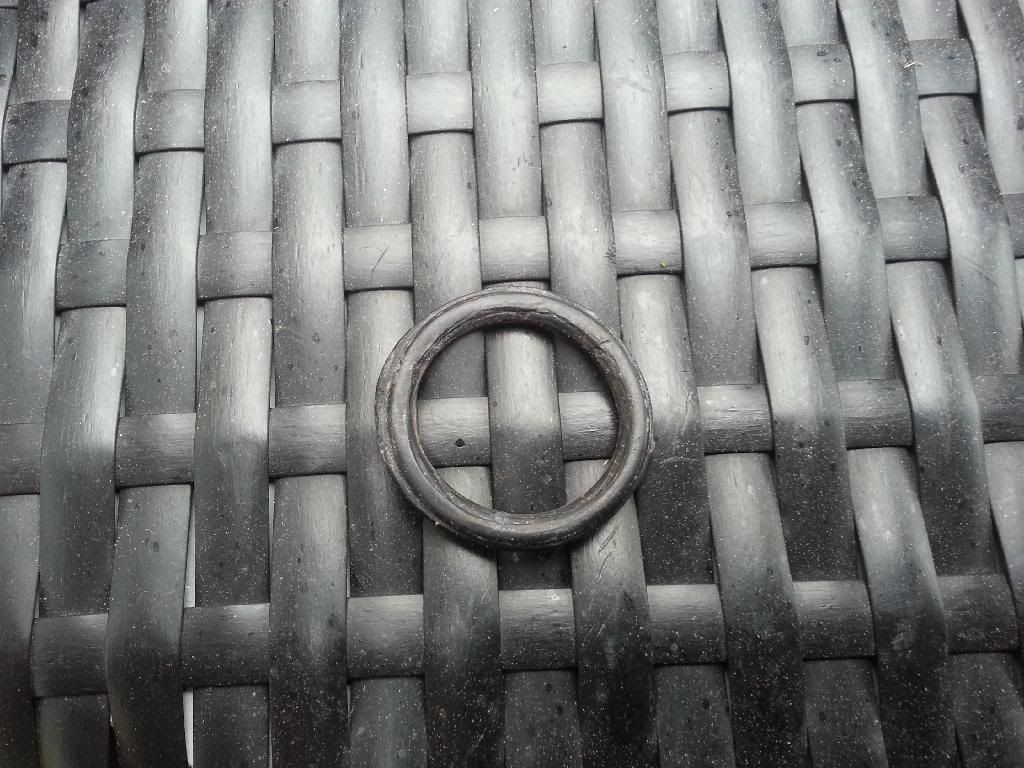

I have ordered a fuel tap rebuild kit so can hopefully sort it so it's not still on when switched to off. The diaphragms and spring all look in OK condition though. Does the NRP diaphragm kit come with the O-ring to seal to the tank? I found quite a mess on removal. Looks like the o-ring fitted was too big and on tightening the previous owner has warped the mounting (see pic). Where can I get the correct o-ring from?
See where it's warped at the top! FFS.
O-ring

Does anyone know the o-ring size and where I can get one without ordering online? Thanks.
O-ring

Re: NC30 running on 3.
I got the correct o-ring through the local Honda shop. Critical that it's fuel resistant material, most rubber is not.
