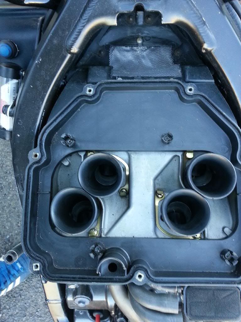

Show me a picture of the gold screws on carbs or ports, I can't visualize them.

Pic from a week ago but you can make out the screws. If it removes a tray is there anything under there I can clean?

No they just keep all the carbs together attached to the tray and the rubber inlets mounted onto each carb. Have you cleaned the gauze filters in each carb yet? To get to them you need to remove the float, when you do then unscrew the float valve, the place where the small float needle thing goes down into. There should be a filter on the end of it or it may well be stuck in the bottom.
