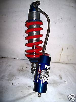

Why do not fit something like this ? In this case you can increase shock size and regulate rear end height.

where can i get one of those from. i like my rear end height kinda high

rider4life wrote:where can i get one of those from. i like my rear end height kinda high
Took this one.I think this reasonable price http://cgi.ebay.com/ebaymotors/Parts-Ac ... otohosting
I have bought mine for 230$.
This is new but 3 time more expensive: http://cgi.ebay.com/ebaymotors/Parts-Ac ... 500wt_1209
