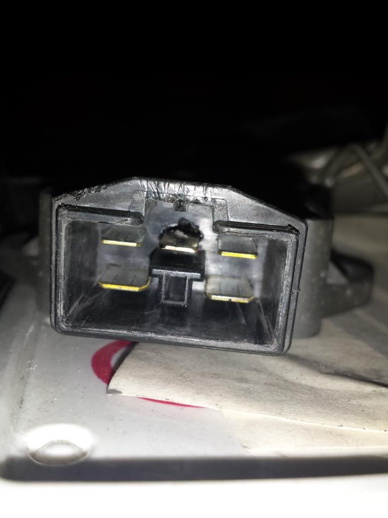

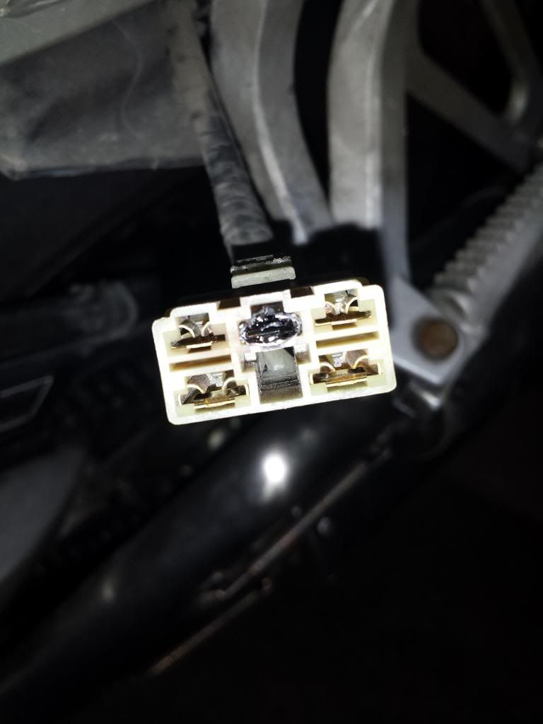

You may find that at some point in the bikes life it's eaten a few rectifier's. If this is the case the plug can take a battering with heat and they often "fuse" together. It's worth checking them on a regular basis if you suspect electrical problems.
Push the tab on the plug and tug very hard...
Cheap enough to replace http://www.ebay.co.uk/itm/Connector-Plu ... 43c066eb92
check the correct size of spade connectors first and I always blob a bit of solder on before crimping.

Okay so my reg/rec is stuffed and the connector melted
Which in turn, I'm guessing, stuffed my battery. I should've checked this a while ago as I smelt wire burning like a couple months ago when I was riding....but I couldn't pinpoint it so I kept riding, eughh...i feel so stupid.
I'll get that heavy duty rectifier from Rick O, I need needle shims anyway..... As for the connector, what size is the spade, and how do I solder and replace the plugs?

I would get. New connecter on eBay and just cut off the old one and wire it in?
