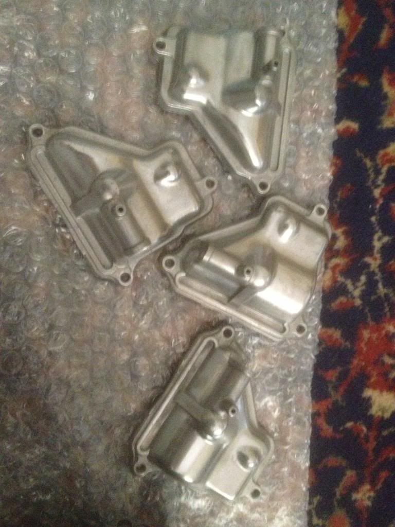

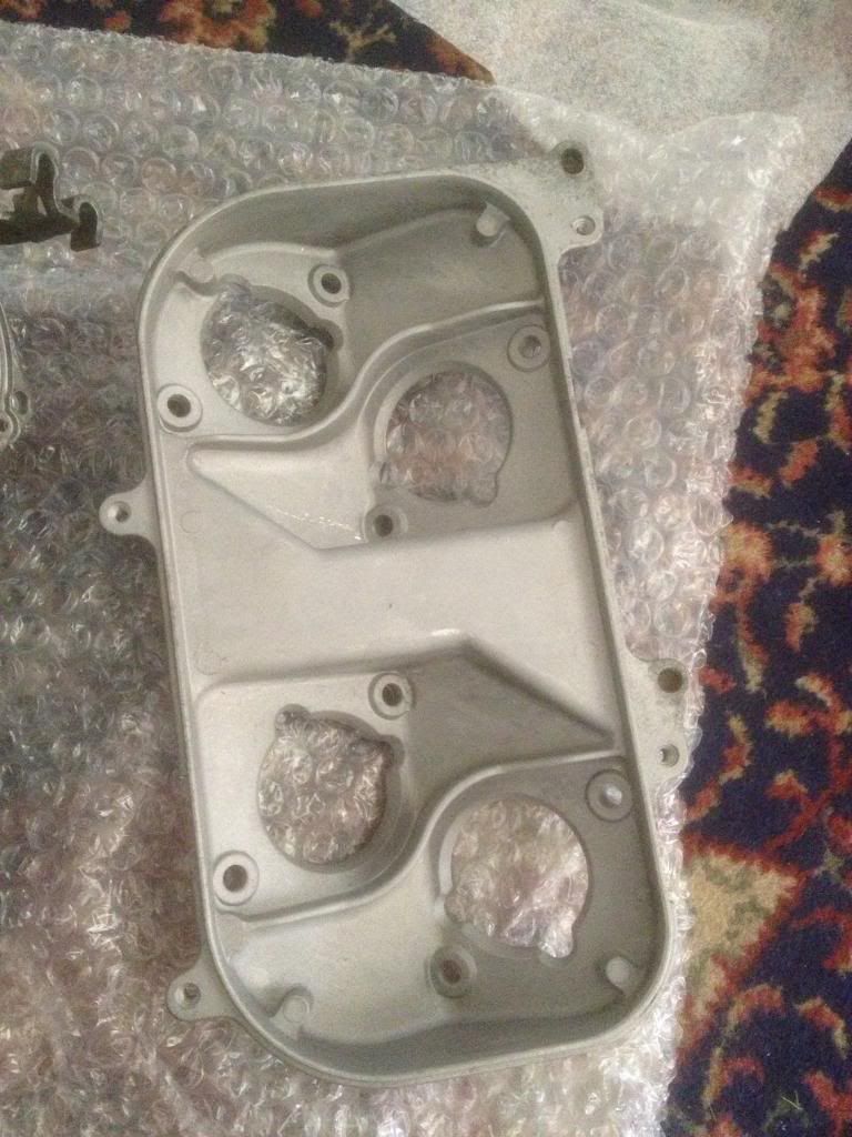

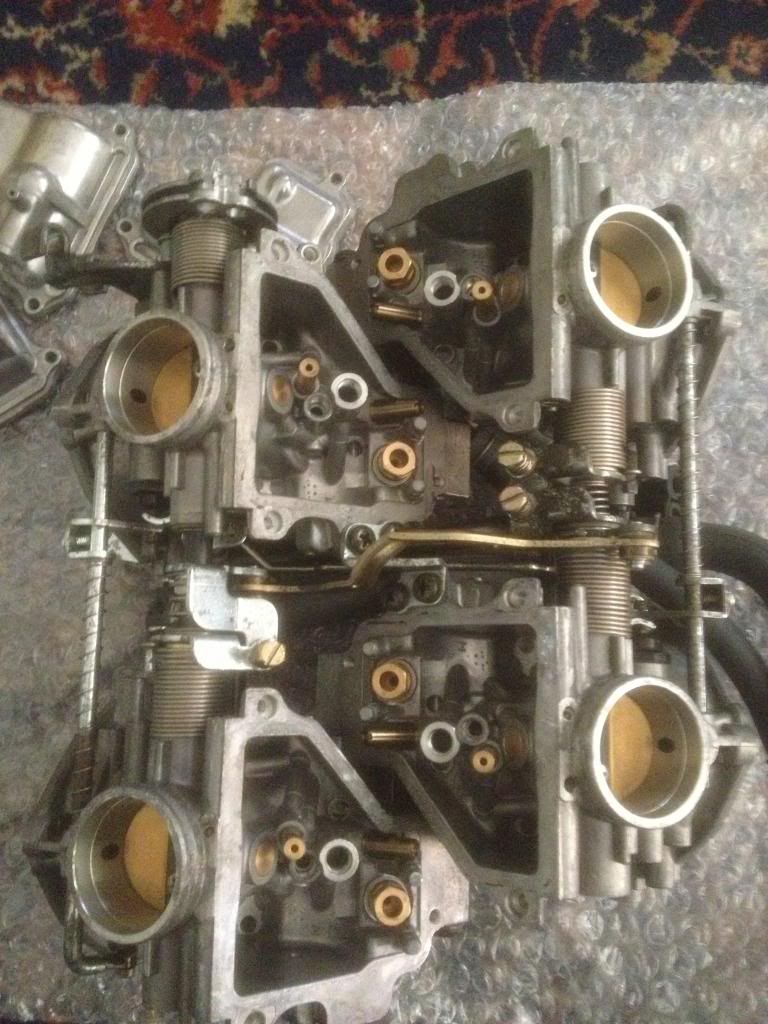

I sent them to Hypermoto in Gloucester.
They did a top job for £10 a carb (for already stripped carbs) plus £10 delivery back to you.
Came back lovely and shiny :peace:
Before:
After:

OK so you sent them in a bank of four, removed jets, pilots, float valves, etc. Did a sweet job and local. Tidy. If you can confirm what you stripped prior to sending that would be great.
bikemonkey
Posts: 1521
Location: Oxfordshire
Re: Carb part, any idea what it is/where it goes?
Post by bikemonkey » Wed Mar 20, 2013 9:39 am

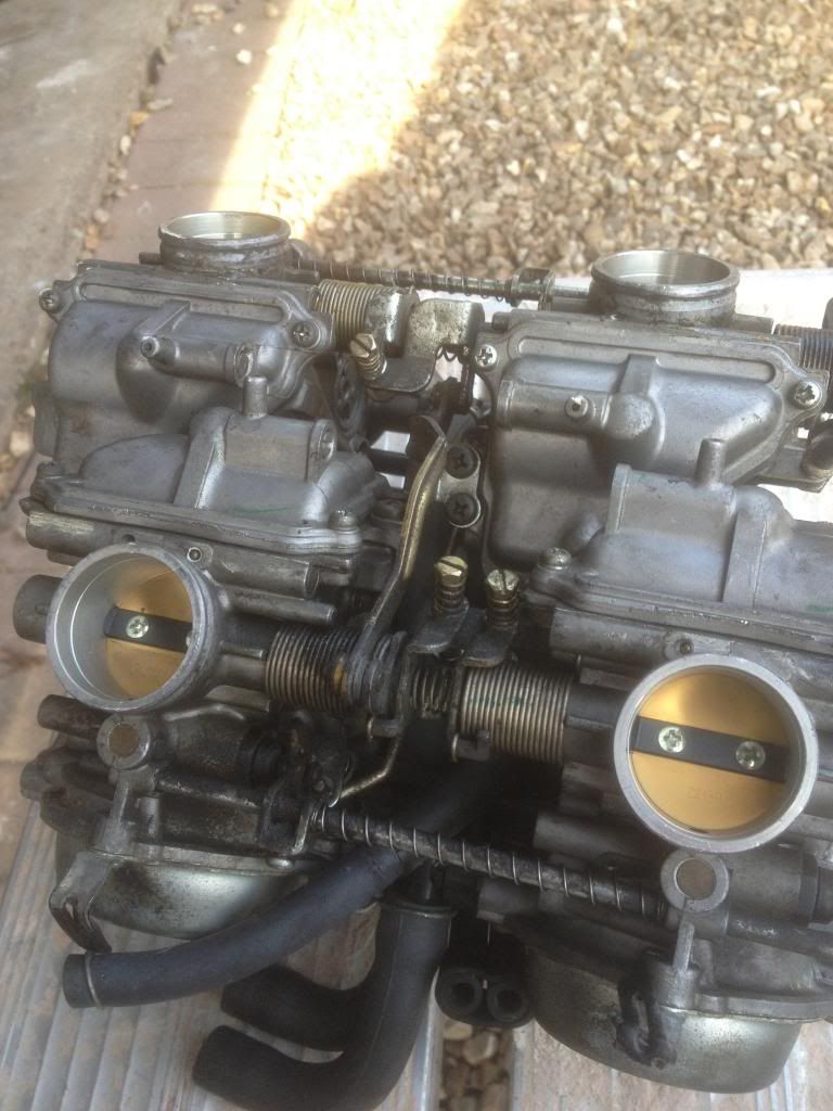

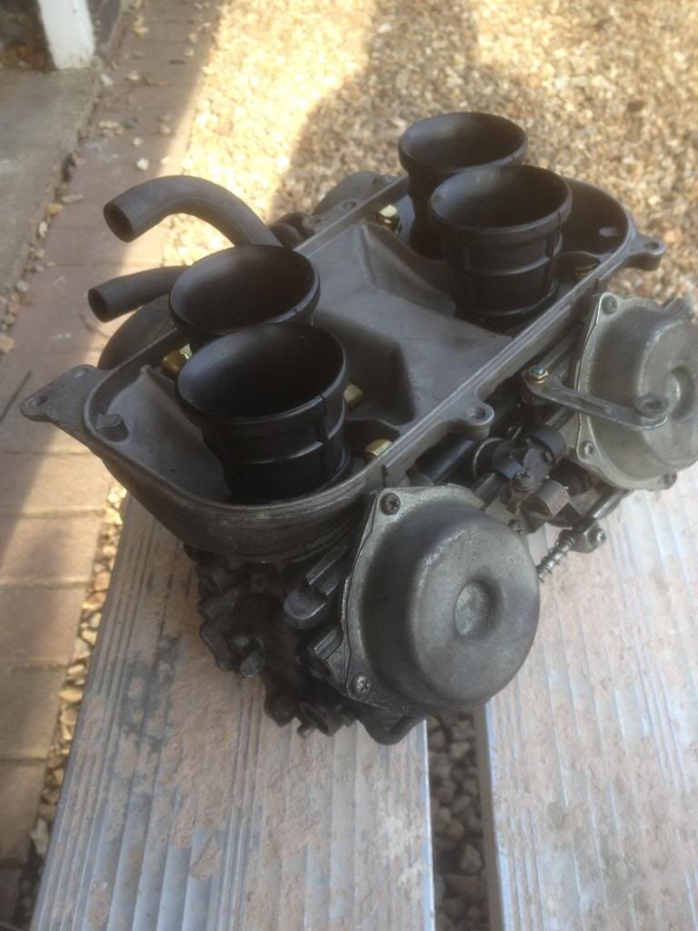

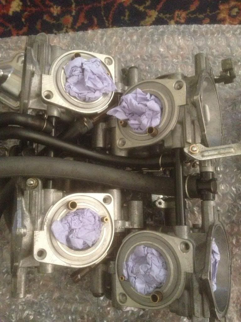

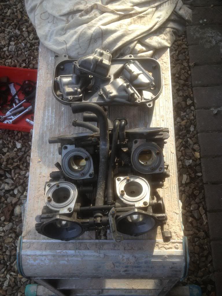

I removed:
Float bowl covers
Pilot jets
Main jets
Emulsion tubes
Floats
Float needles
Slide covers
Slides
Slide springs
Needles
Top plate
Velocity stacks
I sent them everything but the velocity stacks, slide covers, jets and emulsion tubes.
The velocity stacks just didn't need cleaning, the slide covers I polished up myself and the jets were being changed plus the emulsion tubes were clean as a whistle anyway.
I mainly sent the carbs for cleaning as I bought them because the ones currently on my bike are fucked beyond fixing and I'm fed up with playing with carbs. So I'm doing everything properly once this time :peace:
