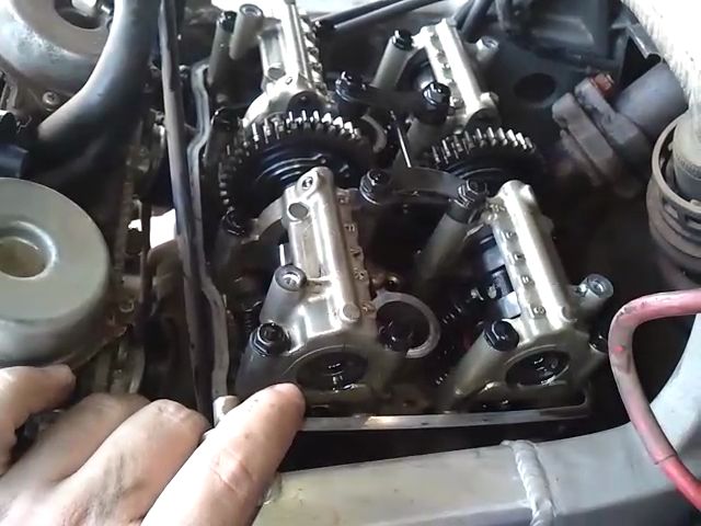

Thanks . I will do that now. I have no idea how it should look but i will take pics.
And for the cover. its only a few holes in front of the filter . I doubt it really made a big difference . But we shall see.

Ok so i got the one head off fast and got the carbs off but i Don't have a 10 spanner to loosen the throttle cables so i can't get the carbs off today. I took a video of the one side. It all looks fine to me but your welcome to take a look and see if you see anything.
Click to see the Video

Do you not have a better image of the valves and camshafts, it comes up really small.

@porndoguk click on the link above the pic the video is big. When I have both heads off I will Take some proper 21 mega pixel pics.

you need to check that you can see the valve stem inside each valve spring for all 16 valves.
while the heads are off, remove the timing cover on the clutch casing and rotate the engine by hand with the appropriate sized socket on a ratched.. I think 14mm perhaps.
Watch the cams go around and feel for any difficulty turning the engine.

Ah I wanted to ask what i can do to get the engine to turn. I will do that now. For now here are pics of the springs and cams (some open some closed).
