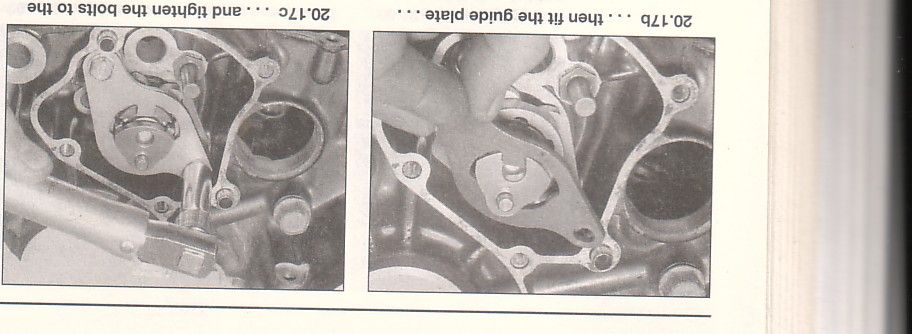

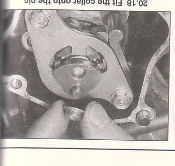

Re: VFR400 Gear Shift Linkage Help
Hope pictures help. Please excuse the inversion., but you should get the idea.
OMG THANK YOU SO MUCH. PROBLEM SOLVED!.
Middle spindle bit needed to be worked in to the plate.
20.17c and tighten the bolt.. how far lol. because i tighten it right up and the gear lever doesnt want to move at all.magg wrote:Hope pictures help. Please excuse the inversion., but you should get the idea.
