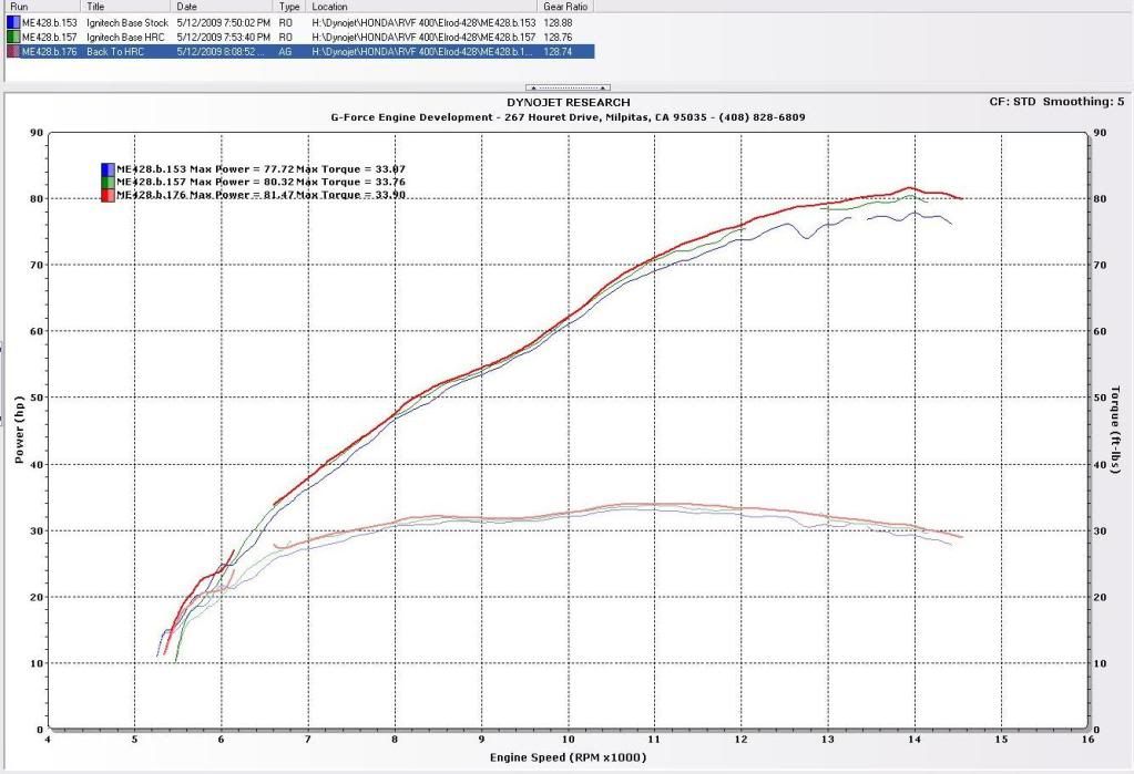

Unfortunately, the HRC map doesn't seem to work like the HRC CDI, so I need to find out why it's different. Any advice is greatly appreciated. The Red graph being the original HRC CDI, the Green being the Ignitech HRC map
