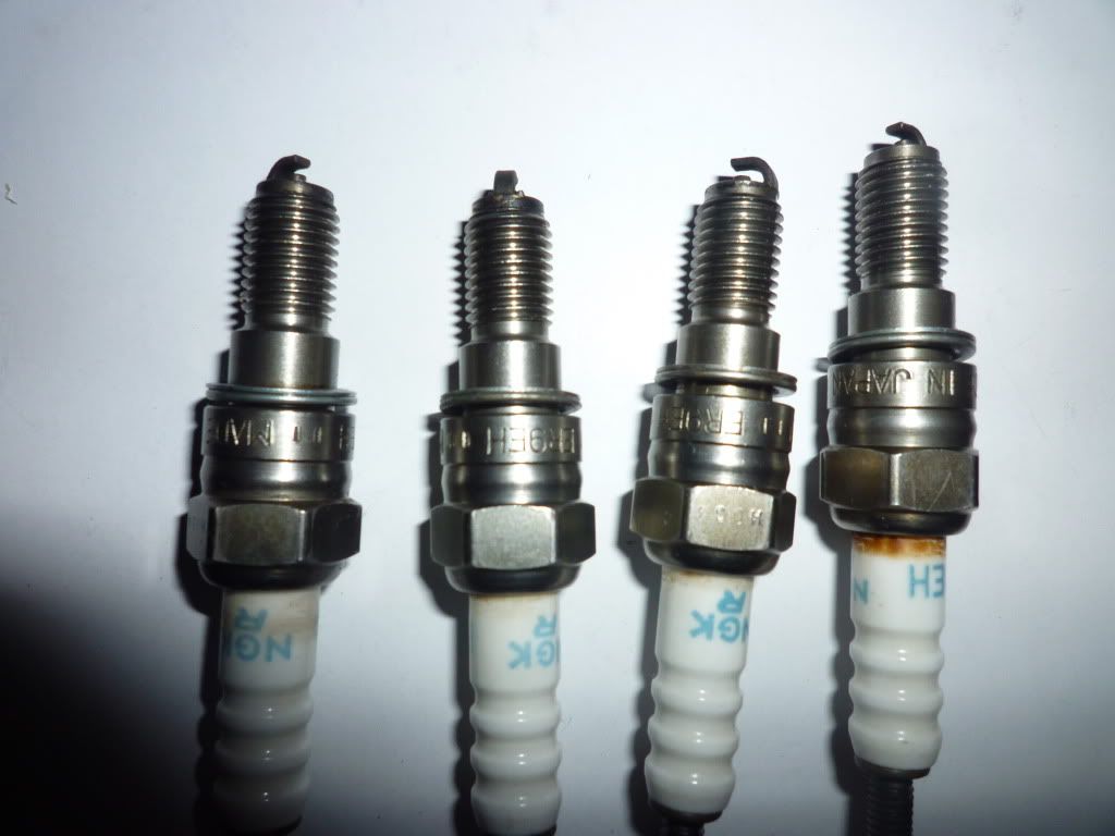

Ok, so the spark plugs were indeed suffering from a bit of flooding. After a scrub-up they look like this:
Do they look good enough to give it a go starting? Or does the brown mark (especially on the right-hand plug) indicate that these are knackered?

It's not very easy to tell the condition of the plugs in the pic, but they don't look crash hot for sure.
Once they've been flooded (it does sound like they have) they can't always be revived.
Try a new set methinks.

I flooded mine the other day and the only way to get it fired was let it stand for half hour and with a booster/starter pack fitted to give it that extra oomph
