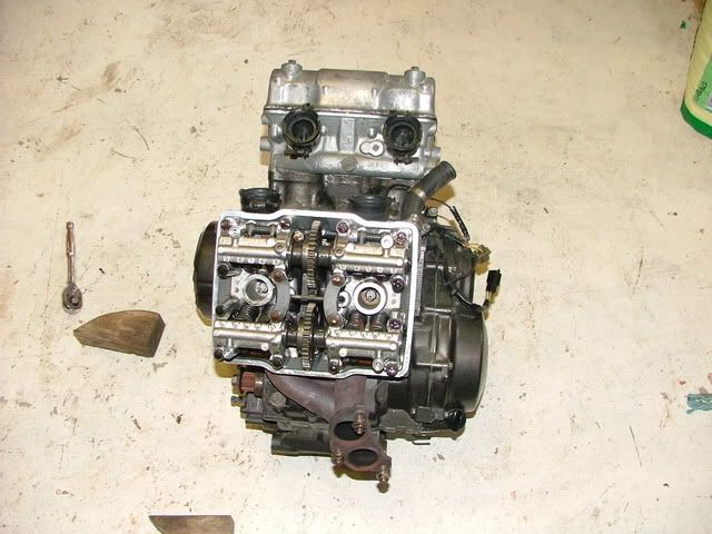

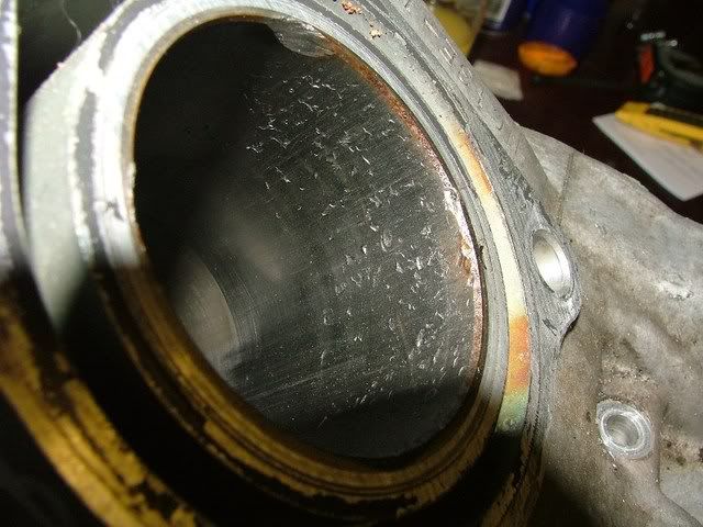

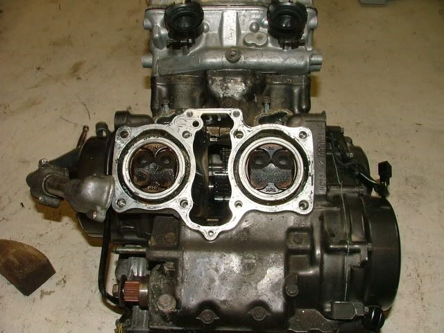

The original engine is already apart on my bench, as i threw a valve, and f**ked one cylinder
. This is now the doner engine.
Pic of the damaged cylinder
This is ready to be transplanted into the NC30 engine

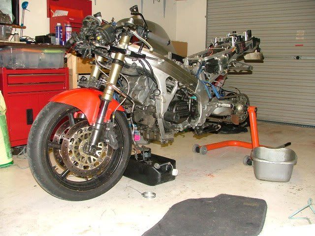

Drain engine oil
Disconnect oil cooler.

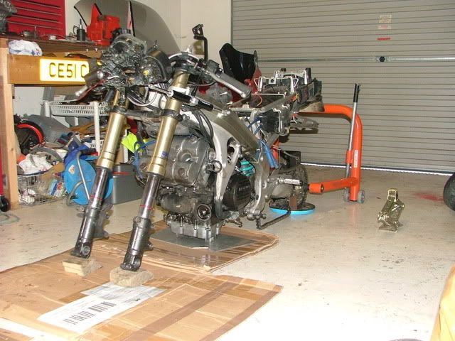

Then i remove the front wheel, but replace the spindle.

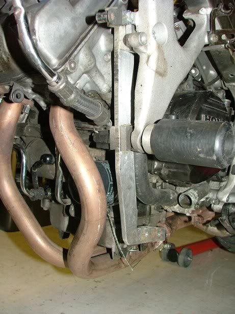

I use the car jack unde the spindle to support the front and remove the front paddock stand and leave the front spindlesupported on the car jack (sorry no pic of that as i had greasy hands and i dont like to leave it supported like that for any longer than i have too.
Gently lower the front car jack till the front forks are resting on 2 blocks of wood.
Then undo all the engine mounting bolts making a note of the castle lock nut positions with a marker pen, remove bolts and store in a safe place.
Disconnect all the electrics not forgetting the neutral switch

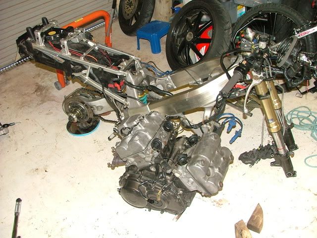

Then with the help of the wife i lift the frame off the engine,
If i lift the frame off the engine on my own i remove the rear cylinder head and exhaust manifold, it just makes it much much easier.

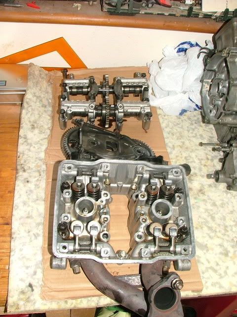

As i had the lift the engine on my own, i decided to remove the cams, and head to lighten it a little.

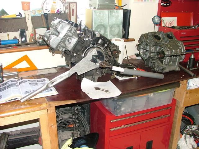

Then to remove the alternator. I made myself a tool to hold the rotor, and use a metal pole on teh socket to get enough power into it.
This is one job that i find easier with the engine on the bench, as the rotor holder can push against the bench and it makes it easier to apply pressure on the socket

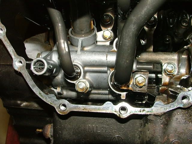

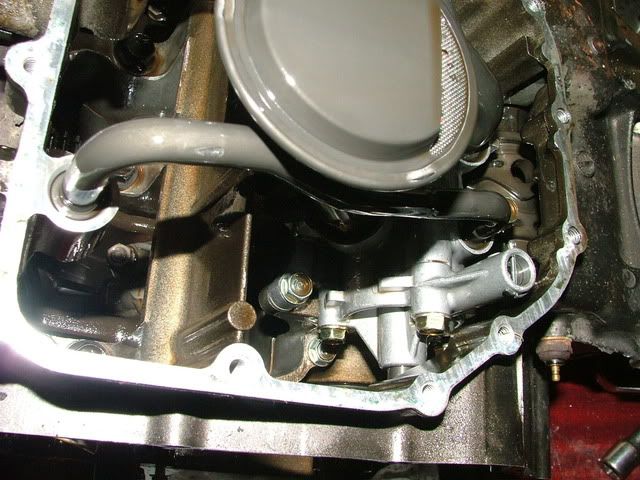

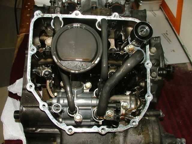

Then to remove the sump, oil pump and filter. This is a UK spec NC30 engine so has a different pump and supply pipe layout.

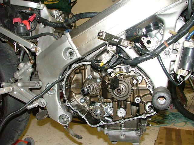

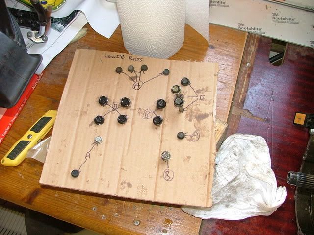

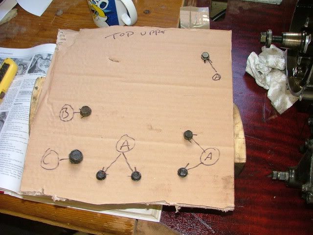

Then time to split the crank cases. Undo the bolts as per heinz manual, and make up marker boards for the bolts,
Lower bolts,
Top case bolts,

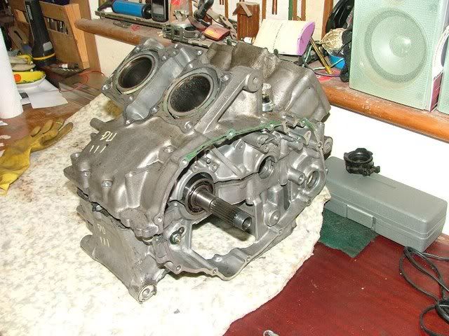

And gently seperate the cases,
You can probably see that the front head is still in place, no need to take it off for removing the gearbox.

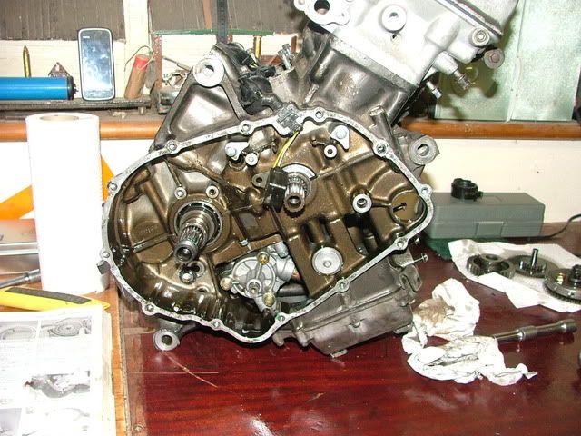

Then time to swap out the old NC30 gears for the NC35 ones
NC35 ones to go in,

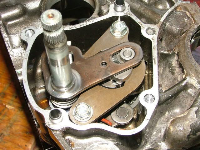

Then time to remove the selector drum and gearchange mechanism.
I fount that because i was replacing the whole lot, there was no need to completely take ity apart.
I just unscrewed the 2No. bolts holding the retaining plate and slid the whole assembly out in one piece.

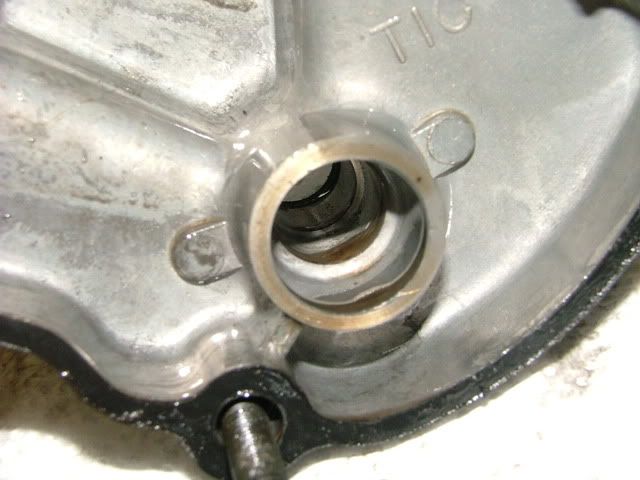

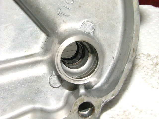

One thing that was interesting, was the outer gearchange casing on the 35 has a needle bearing where the 30 doesn't.
this is the 35 one,
and this is the old 30 one (without the bearing)

UK NC30 engine uses the same oil pump et al as the NC24. Same part numbers.

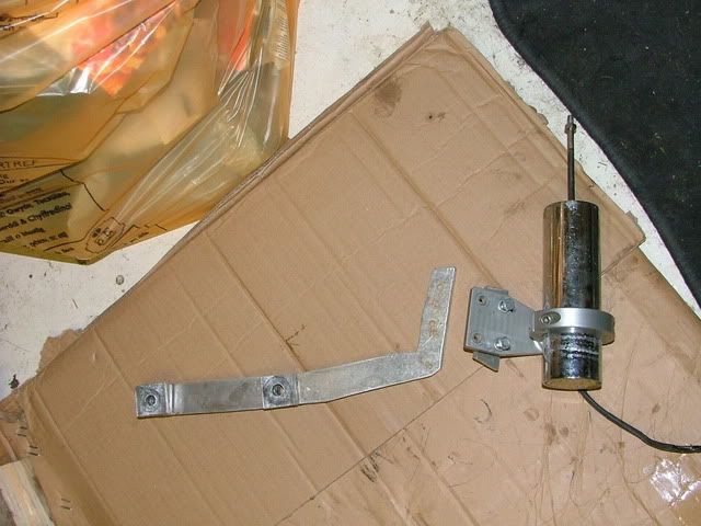

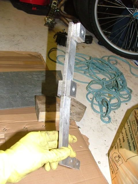

I have a push button gearchange set up on the bike, and this was causing me some issues with the unit hitting the exhaust or being mounted so far out from the engine that the fairing would drag on the floor, see the white scuffs on the red bulge
I have had a different mount made by a friend, it is not perfect but it was cheap and it does the job
It replaces the engine mount spacers on the left side of the engine and mounts the actuator just off the exhaust but closer into the sump.

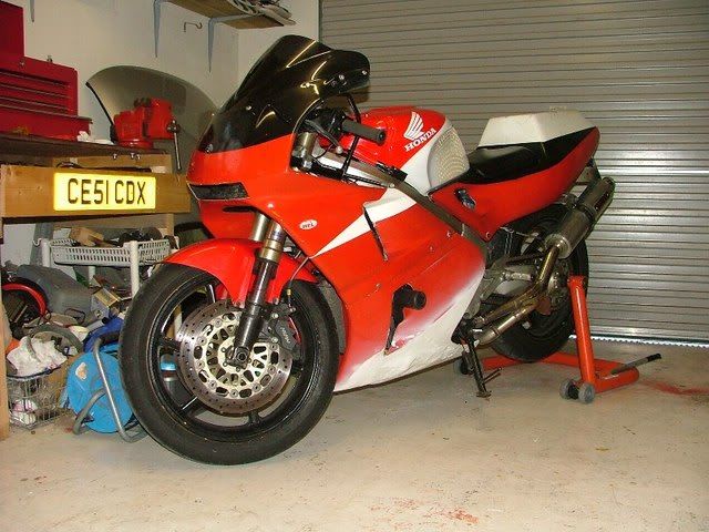

Now i have the fairing back on and teh bike running,
