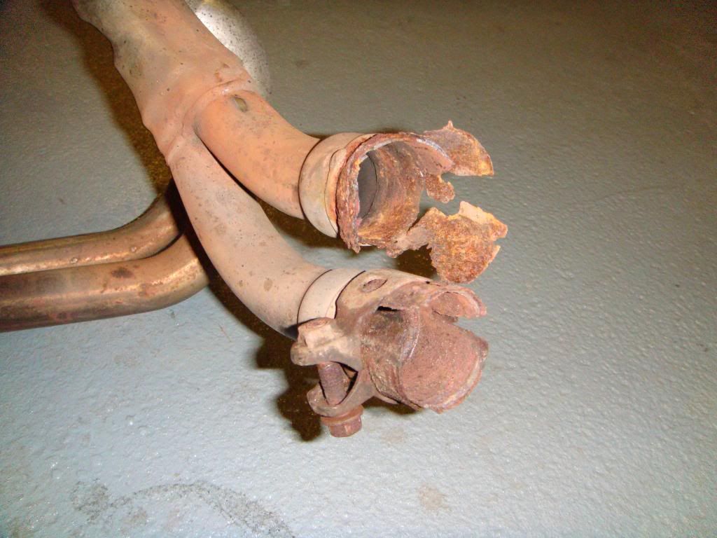

Can someone help? I'm sure I read on here that Honda sell replacement collars for the exhaust from the front headers where it meets the collector box. As you can see from the picks mine are gubbed... What are my options? Does anyone know the part no for the collars or an alternative source and do they require to be welded in or do the just slide in and get held by clamps? Any info would be appreciated...

You'll be needing to visit a local welding firm and they will chop off the scabby bits and weld on some stainless tube for pretty cheap I'd imagine.
The Honda gaskets an clamps can still be got but not collars.
