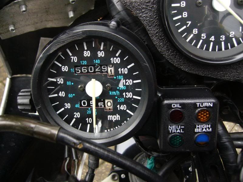

you need to get two spoons and put them under the needle as far as possible and then gently lever the needle off.
Here is one i made earlier!! pity the speedo now reads 68K! that was taken a year ago
as you can see i made a mistake put the needle back on and it now reads over by about 5MPH, which is better that reading 5MPH under
