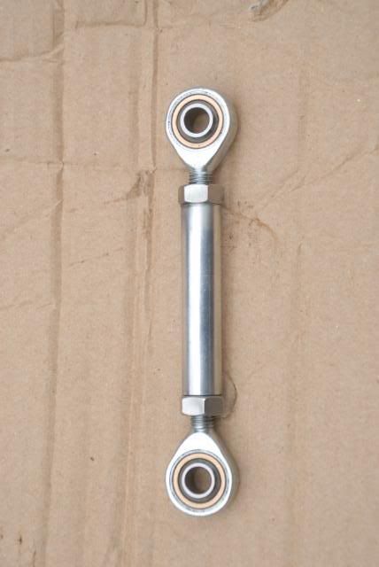

Looks interesting and simple enough to do, The only thing that I'm not sure on it reducing the BM dogbones. How much force is on the weld? Considering when it's been welded it'll have locally annealed it.
Morespeedvicar
Posts: 837
Location: Grimsby
Re: which shock?
Post by Morespeedvicar » Thu Dec 31, 2015 2:14 am
Could you just redrill the holes?. Or maybe put a gusset over the weld?
sportstu
Posts: 5
Joined: Fri Mar 06, 2015 8:57 am
Re: which shock?
Post by sportstu » Sat Jan 02, 2016 1:24 pm
You can't drill new holes as there is not enough material to give it the strength. The alloy weld will be more than strong enough but you could also use the steel Honda dogbone and extend it, the only difference is that you will then need 2 extra spacers because the Honda part is wider.
hunter
Posts: 1292
Re: which shock?
Post by hunter » Sat Jan 02, 2016 1:50 pm
Or yopu could make your own with some alloy bar an rod end bearings.
