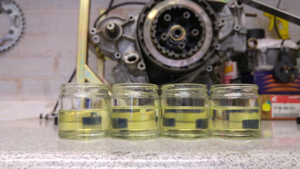

Post by Drunkn Munky » Wed Jul 15, 2015 10:23 am
I let the pump fill the carbs switched it off and left it for 30 mins before removing and emptying the bowls and all seem near as dammit bang on the same,
