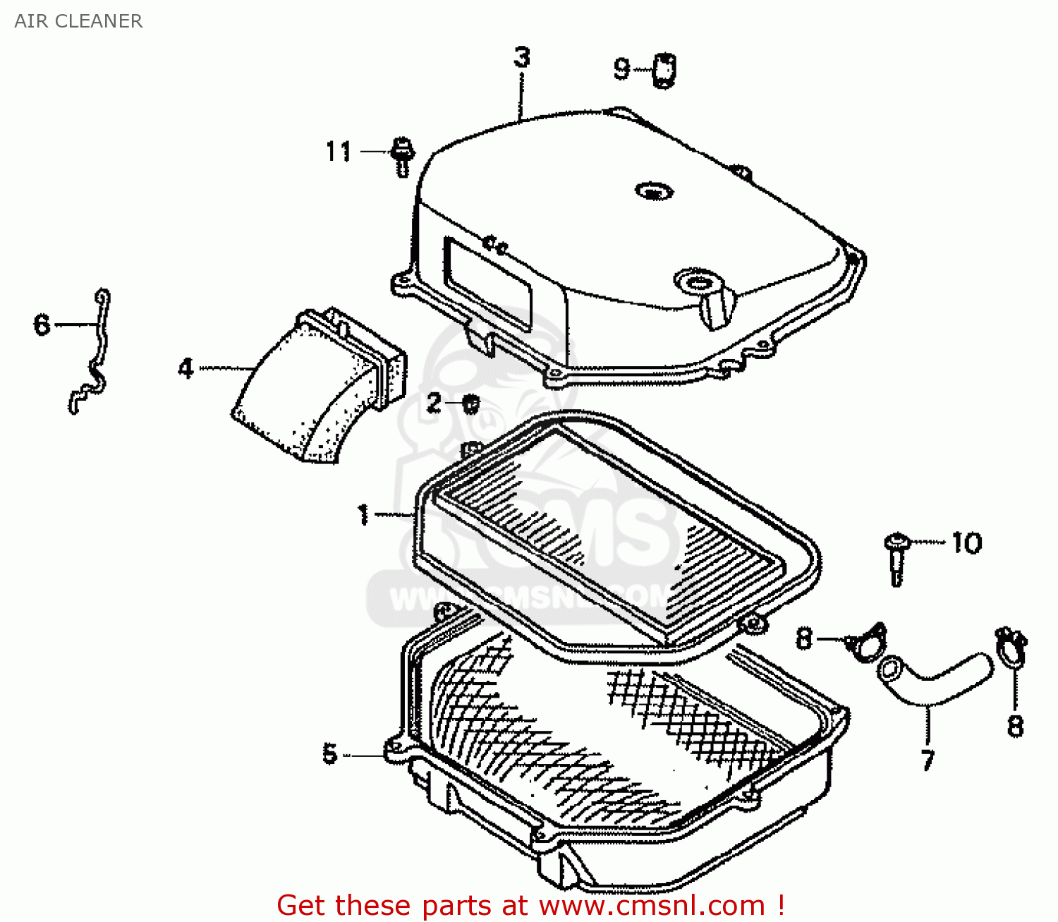

spikenipple wrote:Further to the coil fitting issue, I can't seem to get the airbox base back on with the coils fitted. There is a large tray protruding from in front of the front two airbox>carb screws that goes precisely where the coils sit. Do I have the wrong airbox?
I cant see what airbox you are trying to use as there are no picture.
The NC21/NC24 aircleaner is interchangable though.
http://images.cmsnl.com/img/partslists/ ... 9_b7d2.gif
you can see a picture of it here.
If your carbs are fouling the coils then there is obviosuly something wrong with the fitting of the carbs, which will probably also stop the airbox fitting.

It appears that I have an NC35 airbox, who knows why.
I'll buy an NC21 airbox and that should go on without any problems!
