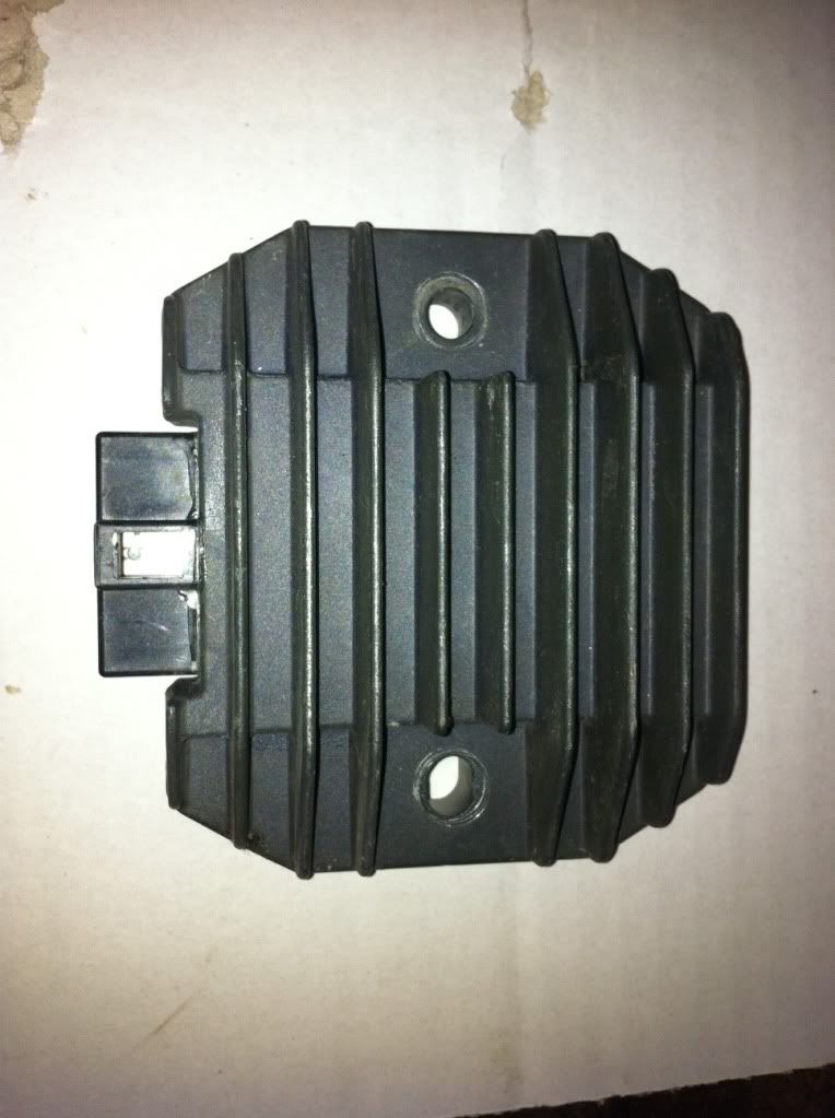

Is this the right R6 rec i must use?

while tryna source out a cheap rec/reg, a shop close to me say they cant get for a vfr but have genuine honda ones that will fit. my question is will this be as good as a R6 one or not?

Genuine Honda ones, especially those without cooling fins are prone to overheating and failing. You can get aftermarket ones that are a direct replacement for the Honda unit from eBay, just don't go for a really cheap one. Even a medium priced aftermarket one will be much cheaper than Hahahonda's spares price. The R6 one is said to be more bomb proof than the Honda/Honda style ones, presumably as it seems to have a bigger area on it to dissipate the heat. I think you need to cut the plug off the loom and fit individual connectors to each pin and the plug style is different. I could be wrong here, so if y ou go the R6 route, wait until you get it. Don't get a different year R6 to that specified, however. I'm pretty sure other years have a different number of pins, and therefore will not work.
