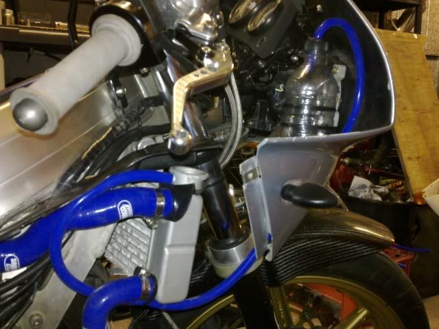

Am i correct in think that this replaces the water header tank that's on the sub frame?
Do i just run the small piece of pipe from just under the filler neck into the bottle?

Re: hrc overflow bottle
CRM wrote:yep thats pretty well it
Also what size I,D hose do i need to come from the rad?
6-7mmmarcus57 wrote:Also what size I,D hose do i need to come from the rad?
all it does is offer weight saving,
i use a kids Morrisons bottle :D
Cheers Ricky , i bought a hrc one ages ago and found it the other day , liking the blue hose.
its silicon so built to take some high tempratures, you only need under a meter,marcus57 wrote:Cheers Ricky , i bought a hrc one ages ago and found it the other day , liking the blue hose.
