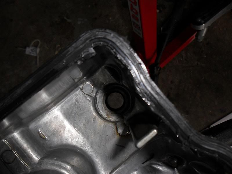

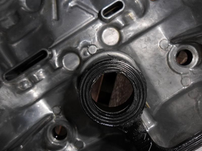

Finally can someone advise me if these cam cover gaskets look OK, on removal something that looked like a rubber/silicone sealant was lifting out of the grooves, I assume it may have been a gasket sealant and I'll need to apply new on reassembly

Might just be held onto the cover with silicone to stop it dropping off. they can be a bit fiddly to fit.
It's not necessary to reapply it.
