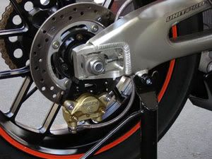

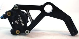

I've always looking for some Brembo Rear Calipers that will fit my NC29. Finally i found this...
in the website they got only for CBR1000, but will these fit on NC29's???
here's the website....
http://www.forged-wheel.com/Relocators.htm

actually im really interested on changing my rear caliper into Brembo.
but my problem is, i couldn't find (for now) any particular model (from honda or any brand) that will fit on NC29's rear caliper.
if i need them.......for me yes.....i hate seing my bike that my front caliper is Brembo and the rear is Nissin. i know its working well, but i want them front and rear to be Brembo. :grin: its like i don't want to wear two different shoes on my feet on the same time. :grin:

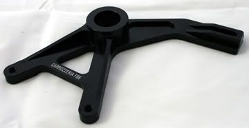

I am quite certain that the CBR1000 will have a thicker axle than the CBR400, so no it won't work without at least a shim in the axle hole. It might be that the alignment slot is also wrong, it's hard to guess.
I also wouldn't bother. Those calipers might look nice but there is no way that you need any more performance than the stock Nissin caliper gives.

An FZR400 3TJ uses a brembo caliper (it's not badged though) and the spindles are same dia as the CBR.
But why not drop Kayla a pm and she can make a carrier for whichever caliper you want.
