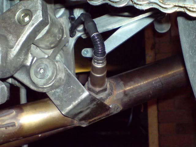

Wozza wrote:Parus - what do you connect the sensor to?
To the laptop. Innovate LC-1 controler has 2 output one for laptop, one - for gauge.
Sensor itself should be connected like this, but more vertical position will be better.
