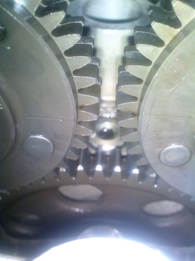

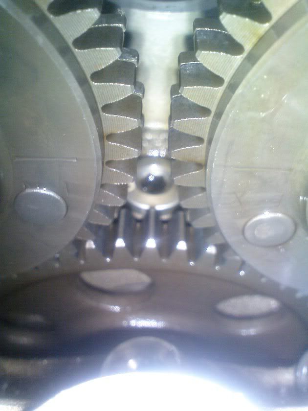

Hey guys, was checking the valve clearances today, along with checking the current shims to find out what needs to be bought.
Just before removing the cams came across something that I thought was somewhat odd.
This is what the timing marks on the cams look like when the gen rotor T mark is lined up with the rib on the case.
In order to get them properly lined up you have to rotate the engine foward a few degrees (if i had a degree wheel I could actually tell exactly how much (it is on my shopping list))
Question is, is it meant to be like this (or off due to manufacturing tollerances) or has someone gone spannering and put things back slightly wrongly
As a side note the bike ran well all summer, as fast as a mates zxr400, altho it did use approx 1l of oil for every 2000 km travelled.
Any of this due to the above.
Cheers, Jac.

more likely that your view of the T mark on the rotor is not perfectly straight..unless you are 12 inches tall.. ;)

aaahhh..that does make sense lol
