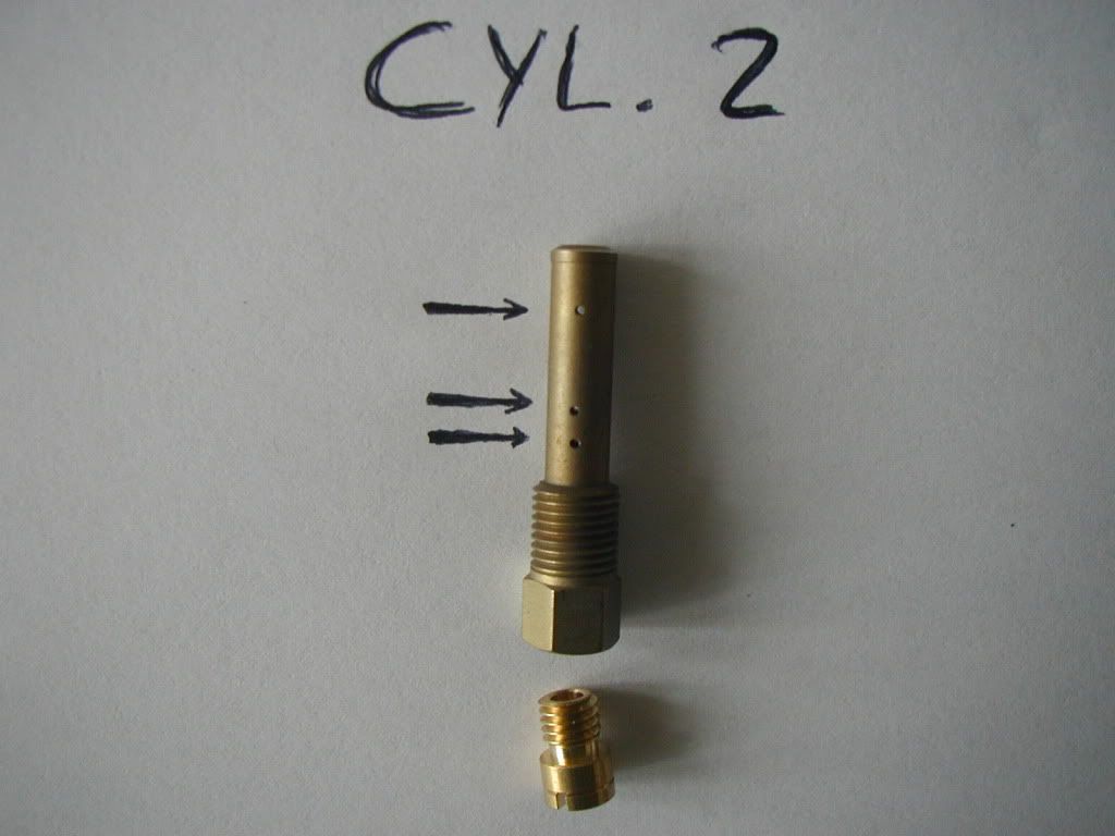

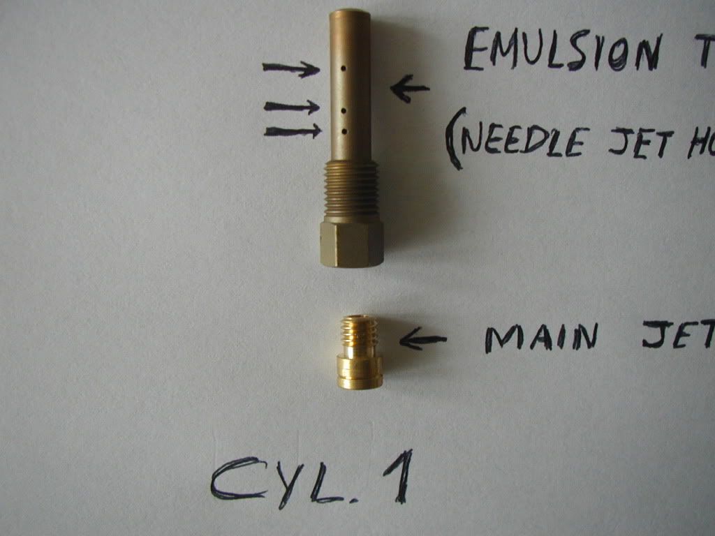

Post by Speedy » Wed Oct 13, 2010 6:20 pm
Well, better late...
So here's confirmation of my RVF emulsion tubes (Needle Jet Holders); they are the correct ones and were in the correct places!
Took some photos for future reference.
Image Image
