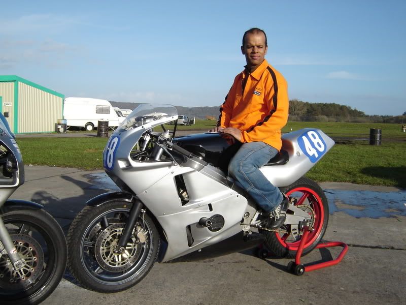

Graeme, which bike of these ^^ bikes is faster and why?? :sshh:
GF Racing
Posts: 350
Re: Uprated Triarm clutch springs?
Post by GF Racing » Wed Sep 15, 2010 7:28 am
Both beat the Kwaks and Yams on occasions with CB riding - however the NC29 was quicker - simply 5 more BHP.
Both ram air - both mag. wheels - both GF trick suspension - both 399cc tuned motors.
The 23 engine came from Shaun Webster (RS Performance) before he retired to the IOM.
Thank you Mr. Honda - Tri Arm was sold - its now going round and round Pembrey - NC29 was essentially destroyed at Cadwell's Mansfied corner in a monsoon wet race.
I still have its twin .... though.
Graeme
