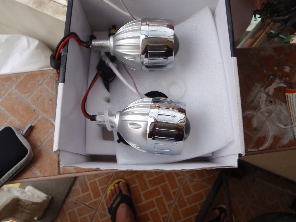

so, i went to our local auto parts shop and got these kits.....
the kit consist of the ballast, wirings, projector headlamp assembly, and some washers and nuts.

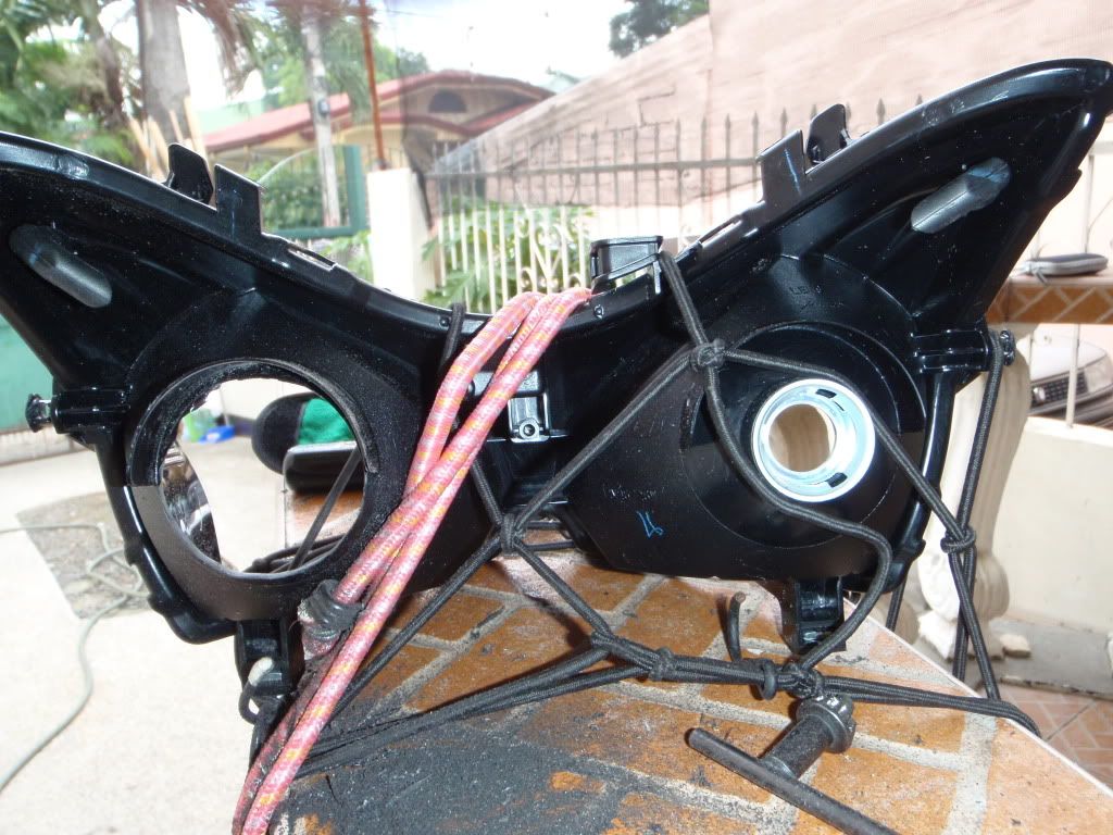

after removing the cover, i have to make a big hole at the back to accommodate the lens.

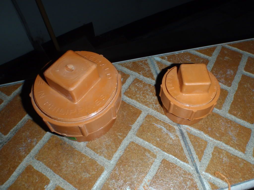

you need also these kind of pvc pipe fittings, i forgot the sizes, but i think these are size 4 " and 2". remove the square portion of the two fittings, make a hole fit enough for the smaller pvc fitting in place. secure with a pvc pipe adhesive or any adhesive strong enough not to make it move.
luckily, the 2" pvc fitting fit perfectly to the washers of the projector lenses.

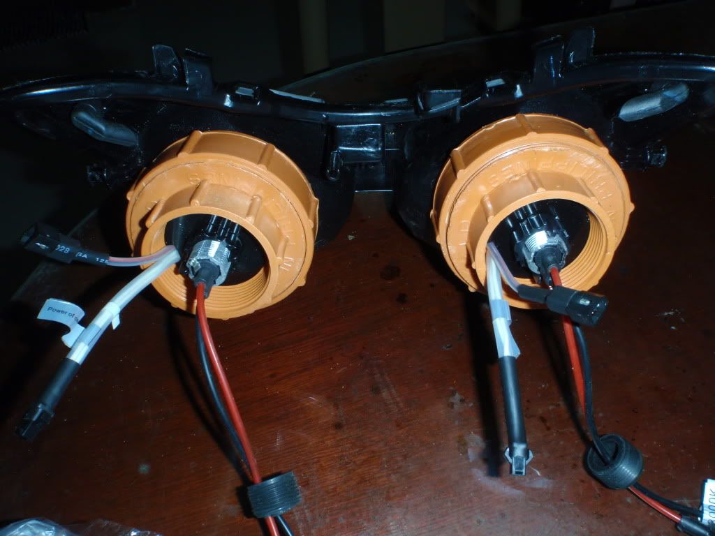

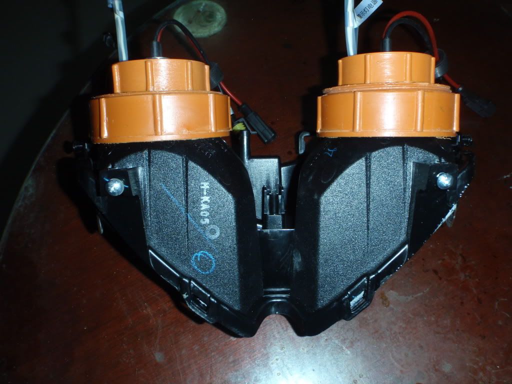

fit the projector headlamp assembly to your pvc fitting and secure it with the washers and nut and it will look something like this....
put again your headlight cover and secure it with silicone adhesive to prevent water from coming in. heat again the headlight with your sister or wifes hair dryer (if you have one thats good too) to make sure that the adhesive combined again.
by the way, secure also your pcv fittings with silicone adhesive, or any adhesive to prevent moist air to get in.
remember the part that you removed from the tyga headlights mounting, you have to drill, put some screws and secure it with pvc adhesive so you can use the tyga headlights rubber cover for the headlights to the 2" pvc fitting cover. (sorry forgot to get some pics)

the wiring of the ballast is very easy, no need to worry. the only challenge is to fit the wiring harness everything in the tyga's front cowl. good thing it has of plenty of space for messy wirings like mine! hehehe!

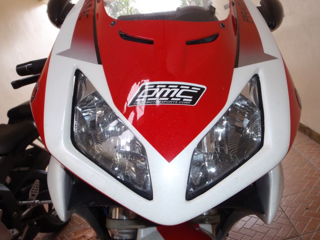

so after securing, and connecting the projector heres the final pic...

before....
after.....
since i used two headlamps, one is black and the other is the keeping the original reflector, i used the original one. im thinking of making my black reflector cover into a smoked-colored-cover or a mirror effect, and that will probably make the tyga headlamps more cool. :drool: im also planning to put an red angel eyes in my next project.
