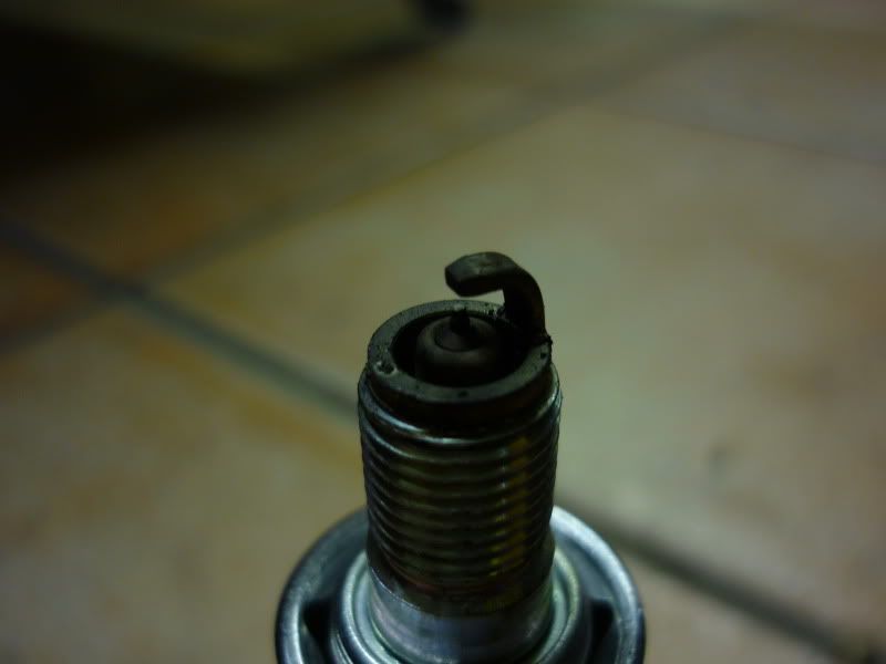

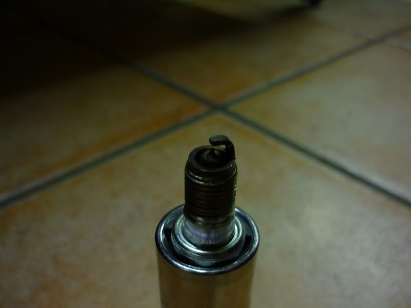

I took some pictures of the spark plugs - looks like if is definitely over fueling.
i have set the pilot screws up to 2 1/4 turns
cyl. 1
cyl. 2
cyl. 3
cyl. 4
cyl. 1
cyl. 2
cyl. 3
cyl. 4
- Posts: 57
- Joined: Tue May 06, 2008 1:16 pm
- Location: southend
Re: Running lumpy NC29 (with pics)
I found out that one of the plugs was faulty so just waiting for a new one to arrive! i will let you know the outcome
