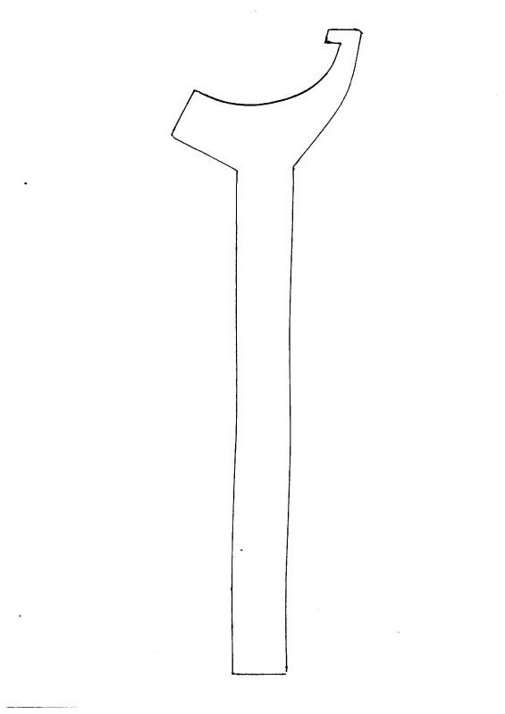

I'm happy to draw up a template from the one I have made at A4 size and email that to anyone who might want to make one themselves.
Use 4-5mm mild steel plate, a jigsaw and a file and it should take about 30 minutes.

et voila
Print out at A4 size and use 5mm mild steel and it should work nicely. I have used alloy plate, but the tip is too soft and it rounds off quickly. I've got the steel in the shed to have a go once my crash damaged hand isn't......
Matt

THanks Matt! 8)
