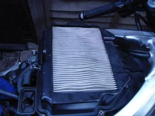

Old Painless

Re: nc30 running probs kin ell
Post by Old Painless » Sat Apr 17, 2010 11:31 am
Previous owners sure do some strange things with the intake snorkel.
Talking of the snorkel, mine has what seem like rubber walls inside separating the snorkel entry into 3 zones but these have been removed, is that correct or incorrect and is this something to do with derestriction or the previous owners stupidity. lol

Post by CMSMJ1 » Sat Apr 17, 2010 11:36 am
what is that lid off? It looks like it needs some work!

ok thanks chaps, :grin: looked on ebay only full airboxes on there also looking elseware any of you guys got a spare snorkel laying around your garages or sheds :pray: thanks again dataracer yeah seems previous owner was in a right mixup with restrictor washers in snorkel missing, speedo on, redrev unit on, a/m airfilter its a bloody minefield i probably would have commited suicide or burnt the thing without this site, still its good way to get to know your new bike !
er! old painless is that off a nc30 it looks quite different to mine even without the home made air ram system attached . :stu
Post by Old Painless » Sat Apr 17, 2010 7:18 pm
NC24 VFR400R-H, sorry for the odd-topic.
Its supposed to be a rectangle, well, it is now. Maybe he though he was building ThunderBird 2. :down:
