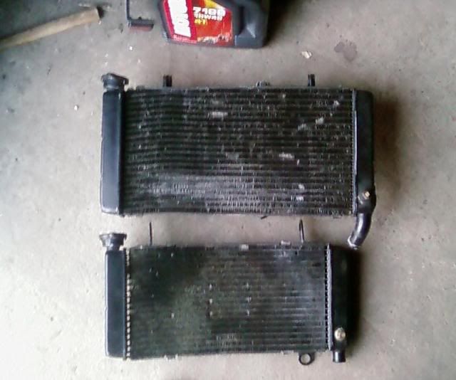

Video: [youtube]http://www.youtube.com/watch?v=g3TbASTqtlY[/youtube]Waza4 wrote:Paurs fitted a CBR600 f2 rad I'm sure he posted it on this site. Your racing it are you ? Otherwise check your thermostat and pump you might have a problem as I use the stock 400 rad on my 600 with no problems.
I'm using CBR600F2 radiator - it's almost bolt on, but need to play with fan fitting and mounting shorter than stock NC29 radiator. This radiator is 20% bigger... here is comparison between cbr400 rad and cbr600f2 rad
I'm going to try cbr600rr07 rad and let you know will it fit or not.
