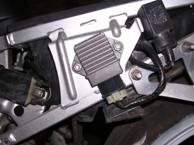

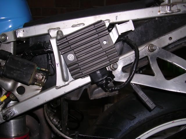

I've never had any dramas with used 2003-4 yam R6 units.
Have fitted 3 now and have picked them all up for next to nothing (tight ar$e!). I don't trust honda units at all.
Before (genuine honda - binned it!):

After (R6):
http://i19.photobucket.com/albums/b171/ ... CN2731.jpg" onclick="window.open(this.href);return false;
